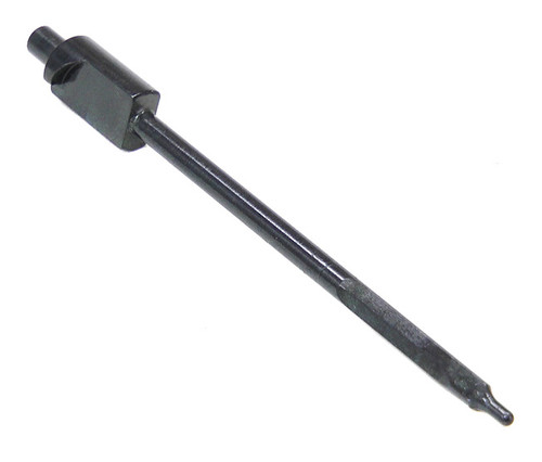

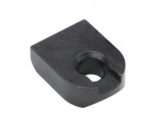

    One substantial difference is that the DE44 has a firing pin blocking mechanism that non ca versions lack. Fortunately you entirely remove this feature by swapping out a few parts. By removing it, it also makes subsequent dissembling easier.
      Fatcat
      • 1299
      The replacement parts would be the firing pin and firing pin stop. It’s shame to spend more money to “correct” the issue on a $2k+ handgun.

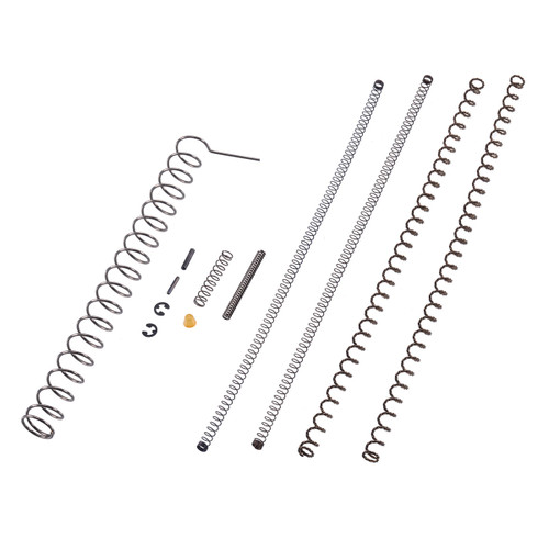

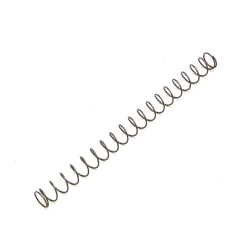

      At a minimum, I wound get a set of recoil springs (there’s 4 of them). Kahr sells a maintenance kit which includes the recoil springs. Don’t cry when you see the price.
      Numerich Arms used to sell the individual recoil springs but I think not anymore.
      and magazine springs. Cheap.

                If you're mostly interested in a .44, I'd hold out for the Mk 7. I picked up my first DE 10 years ago this summer and it was a used Mk 19 CA version. After fiddling with taking out the bolt the first time, I decided I was never doing that again. In addition to being a huge pain in the ***** to remove, the spring for the firing pin stop (CA version only part) is extremely tiny and if it gets away from you, good luck finding it.
