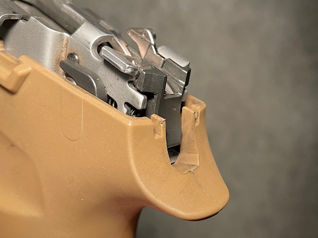

    P320 Tab broken
    Is this still good?

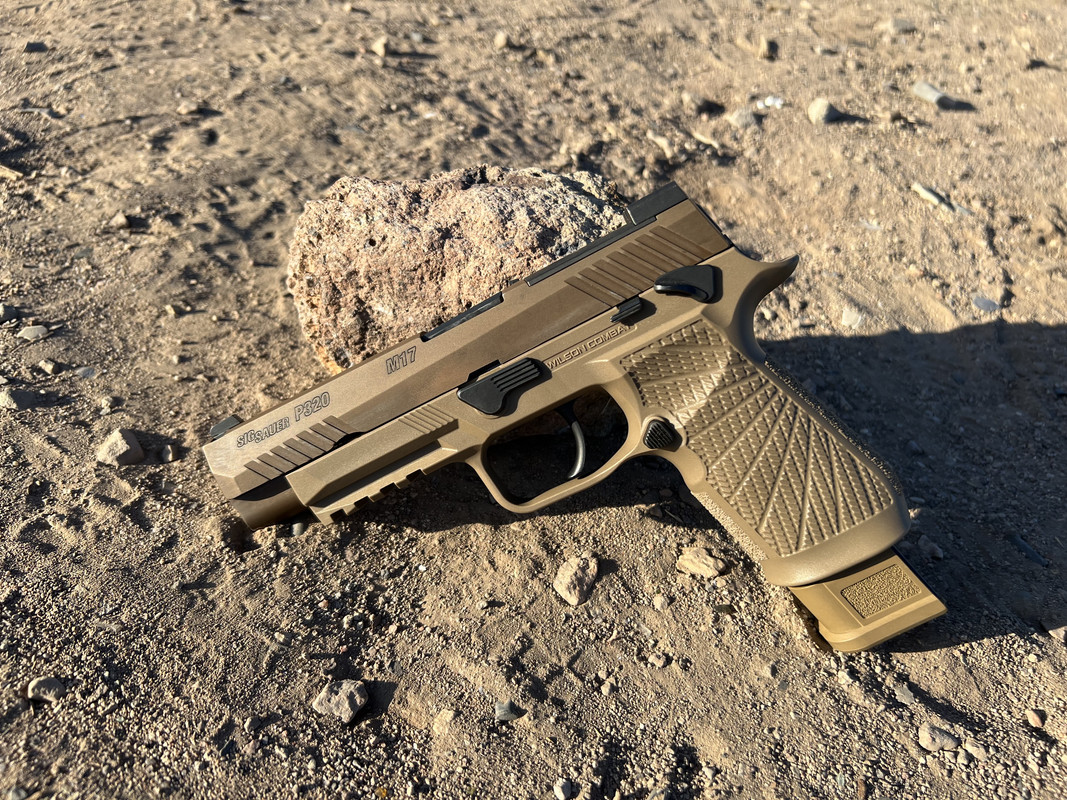

    The frames are cheap, get a new one. Or spend a little more and get an upgraded one from Sig, Wilson Combat etc.

      Thanks. I was looking at that WC or AXG. Maybe they will warranty a free one for now [emoji1696]

          That’s worth a shot.
          I went with the WC for my M17. Much more grip then the stock frame, I like it.

              Looks good

                They feel really good too, especially the front and rear stippling. Nice and aggressive, but not so aggressive it bites into your hand on long training days.

                  that looks nice!

                    The nee grips from sig dont have those tabs anymore. Just cut em off.

                          Those little tabs do nothing. The plastic shelf below them holds the FCU in place against the cutout in the FCU metal. Just clip them flush and file down the rough edges.

                            How did you bent the tab? It is supported on both sides when the FCU is installed.
                              Probably trying to install the FCU. I've had it happen before and like others have said, its no big deal. Those tabs are purely aesthetic and do not affect functionality in any way.
