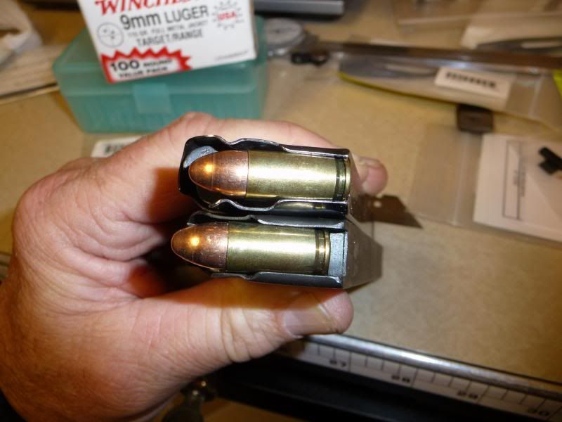

                    Of course it does, until it doesn't. Here is a picture showing the difference of a 38 Super to 9 mm magazine. Note the difference where the round is released.
                    Normally the round's nose contact the ramp before it is pushed up (released) into the breach face to ensure hold and alignment to the chamber (how JMB designed it). Without contacting the ramp, there is potential to cause a stove pipe or nose dive. Why it works 90% of the time because the round is held by the extractor against the breach face to jump across the "gap" while shooting stationary. Thus, it can work most of the time, just depends on how much reliability is needed. Range toy, why not. Using it for dash and shoot, or competition involves movements, probably not.
                    • #25
