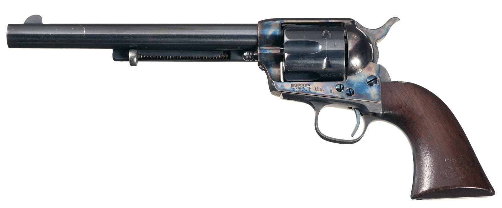

          Well, it's an anniversary model commemorating the original version and 7 1/2 inches was the barrel length of the original version issued to the US Cavalry, so I would keep it like that and get another SAA-type with a shorter barrel if that's what you would prefer.
          To see an original, here is "The Finest Known Documented 1880 Production Colt Cavalry Model Single Action Revolver" that sold at auction for $161,000:
          The Finest Known Documented 1880 Production Colt Cavalry Model Single Action RevolverThis is an example of a totally original Colt U.S. Army contract Cavalry Model Single Action revolver manufactured in 1880 and inspected by Ordnance Department Inspector Lieutenant David A. Lyle and Sub-Inspector David F. Clark. The revolver is accompanied by a Colt factory letter that identifies this revolver as one of 150 Colt Single Action Army revolvers delivered to the U.S. government inspector at Colt on April 21, 1880. A Letter of Authentication from Colt Single Action expert John A. Kopec contains a detailed evaluation of the revolver. The Letter of Authentication states "the subject revolver is 100% authentic in every respect. There is no evidence that this revolver has ever been fired". The Kopec letter describes the finish of the revolver as "remarkable to behold" and states that "The color casehardening is "as new." and "The blue finish on this revolver can easily be described as being 99%+". The revolver has the low luster, Colt "Military Blue" finish on the barrel, ejector housing, cylinder, trigger guard and back strap. Feathered polishing marks are present on the barrel on either side of the front sight blade and above the ejector housing screw. The frame, hammer and loading gate are color casehardened with vivid case colors. The screws and trigger have a fiery, niter blue finish. The one-piece grip is oil-finished black walnut. The revolver has the early style bullseye ejector rod head and cavalry style hammer with elongated bordered knurling on the spur. The top of the barrel is roll-stamped with the address "COLT'S PT. F. A. MFG. Co. HARTFORD CT. U.S.A". The address is the same style used on Henry Nettleton-inspected Cavalry Model revolvers and has two lines under the "o" in "Co", a broken serif in the "T" in "PT", a broken "M" in "MFG" and a broken "A" in "HARTFORD". The underside of the barrel is stamped with a "P" proof mark and the Ordnance Sub-Inspector initials "D.F.C.". The left side of the frame is stamped with the Colt three-date/three-line patent markings and the "U.S." property mark. The "U.S." mark has square periods and raised areas around the letters where it was stamped into the casehardened frame. "D.F.C." is stamped on the bottom of the frame above the serial number. The assembly or batch number "3198" is stamped on the inside of the loading gate. A "P" proof mark and "D.F.C." Sub-Inspection mark are stamped on the cylinder behind the flutes. The full serial number, "55104" is stamped on the bottom of the frame, trigger guard and back strap. The partial serial number, "5104" is stamped on the cylinder. The revolver was not disassembled to examine the partial serial number stamped on the barrel underneath the ejector housing. All of the visible serial numbers match. The left side of the grip is stamped with the date of inspection "1880" above the final inspection mark which consists of the script initials "DAL" with an oval border. The right side of the grip is stamped with the Ordnance Sub-Inspector's mark which consists of the script initials "DFC" enclosed in a rectangle with rounded ends. The small "D.F.C." Sub-Inspector's mark is stamped on the left grip heel. The Kopec letter states that this revolver was a new listing in his survey of Colt Single Action revolvers and that the closest identified Cavalry Model Single Action in this serial number range is serial number 55923 which was identified as belonging to Company F, 6th Cavalry regiment on August 3, 1888. The Kopec letter states that this revolver probably was unissued and remained in arsenal storage until it was sold to a private individual in the 1920s.
