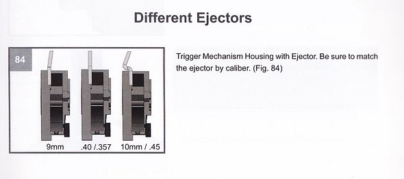

      You will need to change the ejector in the trigger housing to a 9mm.
      If your G19 is a the recoil spring and guide for the G19 won't fit. Use the G27 spring assembly, although it may be to strong and result in short stroking.

            You should be fine if you already have a non oem guide rod. Short stroking is where the recoil spring is to heavy and won't allow the slide to recoil enough to strip the next round from the magazine.
            As I said before you will need a different ejector. The ejector is located in the trigger housing. You will need a 9mm.The 9mm ejectors you can use are #336, 30274 or the latest 47021 All will work though. Right now ejectors are in short supply. Especially the later 30274 and the 47021
