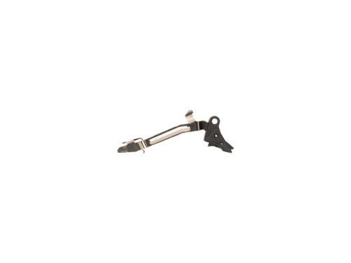

                    It depends on what you are trying to accomplish with the trigger swap. The one thing I hate about Glocks is the trigger shoe. After long shooting sessions on colder days, the trigger shoe and safety bites into the finger. I swapped all of my Glocks to Overwatch's PolyDat trigger. It comes with the flat shoe and a polished trigger bar assembled. It also slightly reduces pre-travel. It does not alter trigger pull weights. I am fine with stock pull weights. The only exception is my G30 which for some reason had a felt heavier weight, so I did swap in a 3.5lb Ghost Edge Connector, but this is the only one of my Glocks with this mod. All of them do have the Overwatch trigger though, including the G30.
                    $60
                    OP is pleased to introduce the first flat-faced aftermarket polymer trigger for you Glock pistol upgrade. With a reduced cost, there's no reason not to upgrade.
