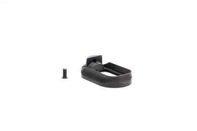

                    SkyHawk
                    • 23438
                    Strike has one, not sure about the 10rd mags and it doesn't say
                    Introducing the Strike Industries Gen. 3 Magwell for GLOCK™ 17! Our Gen 3 Magwell was designed to provide easier reloading of the magazine while adding a stylish look. Compatible with most aftermarket magazine base plates and extensions. (Aso compatible with G22 / G31 / G34) *Not compatible with backstraps installed on the GLOCK™ frame.Compatible with GLOCK™ 17/22/31/34 Gen 3. WARNING: DO NOT OVERTIGHTEN set screw when installing the magwell. Overtightening the set screw will throw the magwell alightment off and also damage the magwell and/or firearm. If you are unsure, please contact our customer support team or consult with your local gunsmith.
                    The SLR units are very nice, can't go wrong there
                      Sold out and doesn't look like they are continuing to make that one, given it was on clearance. Looked like it would do the trick, though.
