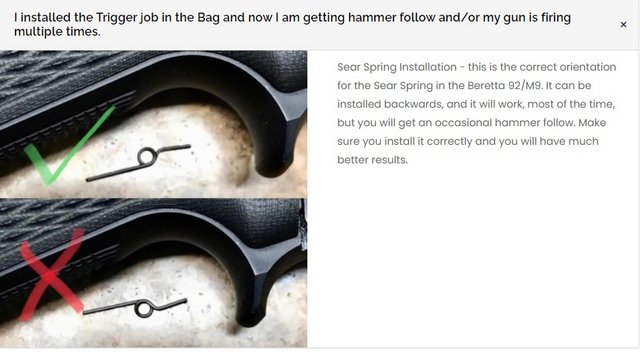

    I have a Langdon Tactical 92 Elite LTT. Langdon did the install on everything and I haven't experienced any issues.
    but just reading your post, the first thought that came to mind is your sear spring is installed incorrectly.
    If you've already checked this and your sear spring is in the correct orientation, and you're still experiencing this issue....it's something else.
          BINGO. Thank you Champ for doing what I should have done: Checked Langdon's site. Many Kudo's good sir.

                  So was the sear spring backwards?
                        Yessir, also in comparing the LTT supplied sear spring, I noticed the angle is reduced by about 3 degrees (which makes sense, the poundage on the spring is reduced). I torqued it about halfway(1.5 degrees) between how it came and the stock spring to increase the weight required to release the hammer because I want a little added safety after today's experience.

                        I am not entirely sure. The reason my girlfriend was inducing the burst fire (unintentionally) is because of how she was taught to shoot by a naval sniper. They don't reset the trigger during recoil, so she was creeping the reset and with little to no sear spring pressure the sear was essentially dropping the hammer consecutively in that .5mm space.
                        I'm making an assumption that that's how you induce the burst fire, but mechanically I can only imagine that that was the cause.
