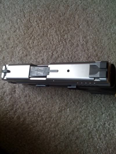

When they sent the slide back, they sent it in a small plastic case, pictured below, which may come in handy. It's not super sturdy or anything, but it's big enough to hold the whole pistol. They sent the case inside a cube shaped cardboard box. The packaging was discreet, and did not say Springfield Armory, or anything that would make people think the package was related to guns.

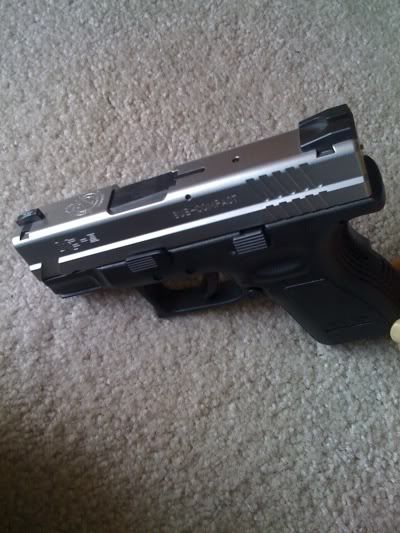

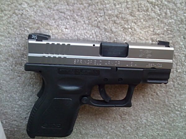

The Springfield Custom sights are the XD-M style sights with Trijicon lamps installed in them.
Since Trijicon sights cost exactly the same, here's how I would compare them.
The Trijicon sights are much more similar to the stock XD sights.

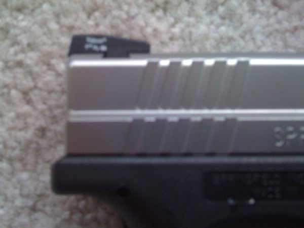

The Springfield rear sight has a flatter profile, which may make it less likely to snag on the draw.
The back of the rear sight is flush with the back of the slide, so the sight radius is a little bit longer.

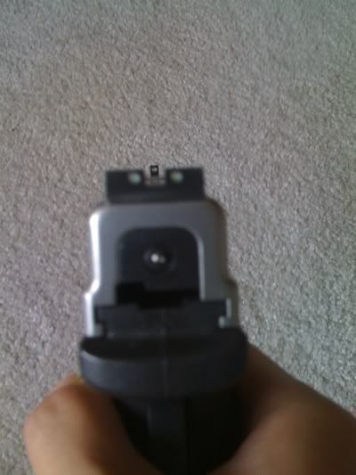

The notch in the rear sight is narrower than on the stock XD sight, which means getting a flash sight picture is a little more difficult.
The Springfield sights don't have a white ring of paint around the tritium insert. They have a metallic ring. I think I'd prefer the white, which the Trijicons have, but this may be a preference thing.
