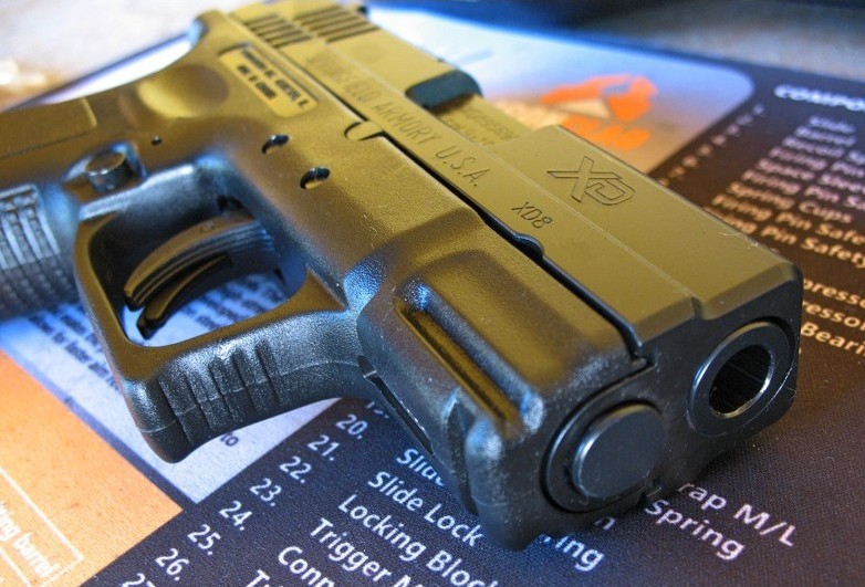

                          dont know if it matters but with the slide fully forward, the end of the guide rod sticks out about 1/8" past the barrel, supposed to be flush.

                            the guide rod on the XD9 is normal to stick out

                            on the Springfield XD9 the guide rod is Its suppossed to be like that, its a feature called the stand off device. So if you press the muzzel into your target the guide rod hits the target and not the slide. If the slide hit the target the slide could open up so you cant make a contact shot.
                            it should fire the live round as is
