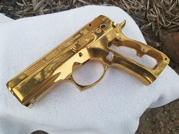

        This is the hammer it’s got... is that really considered aftermarket that needs to be fit with the sear?
        Screw it.. ordered the adjustable sear after reading the description

                    Are we not going to address the gold plating?
                      fawndog
                      • Nov 2003
                      • 856
                      It's Ti Nitride like drill bits, making it OK.
                      DLC would be better, but hey OP might be on to a untapped market with a Tiger King CZ

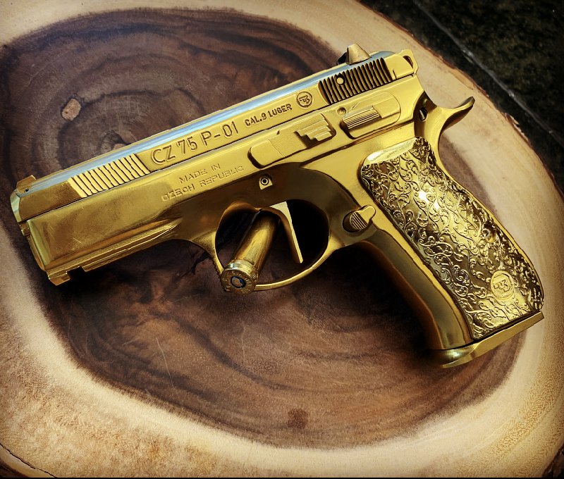

                        Here’s a photo of it for the curious.. adjustable sear has no ETA yet
                          Tok36
                          • May 2013
                          • 3061
                          Neat, you are going to have one unique CZ.
