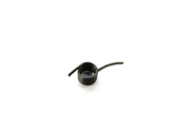

                  I was reading you can also use a witness sear spring to make the trigger pull heavier. https://benstoegerproshop.com/eaa-ta...ar-spring-9-3/
                      Thanks. Interesting. This is to go on the CZ's sear, right?
                      Picture of the part railroader is referring to:
                      I was thinking of CZ Custom's Carry/Duty Hammer:
                      and their Heavy Trigger Return Spring:
                      Wonder what trigger weight does Cajun's Defensive Carry Package if combined with CZC's Heavy Trigger Return Spring gives? With their provided TRS, the SA is 3 lbs 8 oz.

                        On the sear spring I just did a search and using that sear spring came up as working to make the trigger pull heavier. I think if you change the hammer you might have issues with your safety working correctly with your stock sear since it's fitted for the shadow hammer. I put a CZC hammer in a 75Bsao and I had to adjust the sear arm because the safety wouldn't work. I guess you could always use a CGW adjustable sear if you need too.
