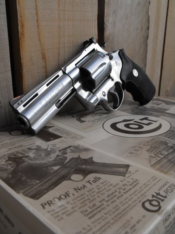

        Anaconda: Built on a larger frame than the Python, it looks like a stainless Python on steroids to fire .44 Magnum or .45 Colt. Mfr 1990-1999. A few hundred made 2002-2003.

          Slabsides
          • Apr 2009
          • 57
          Colt Anaconda
          Doing right isn't always easy, but it is always right!
