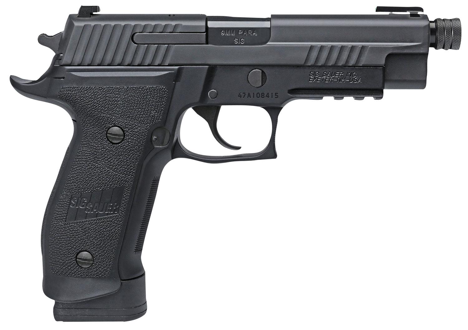

      Right-o. All 226 mags should be the same. Even the TacOps mag will fit in a regular 226. The Tac-Ops models have grips that extend downwards to make a sort of built-in mag funnel, and that's why they come with those long mags:
