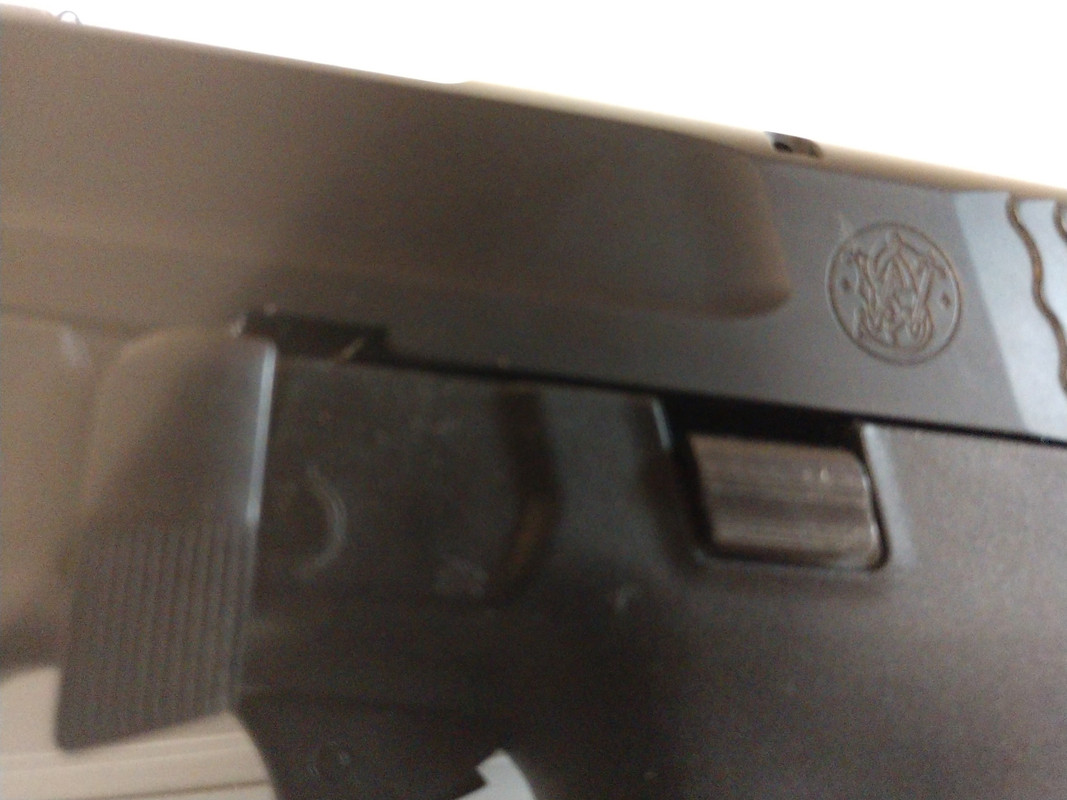

                Picked up the gun (the lower actually) today from LC Action and when I got home, I put the slide on. Now, I can't get the slide to lock back nor can I remove it...arghhhh.
                Checked out some YouTube vids and I guess this problem happens on occasion. Problem is there's a spring near the take down lever that gets out of place and prevents removal of the slide. As per the video (link below), I tried depressing that spring with a flathead screwdriver but to no avail. Looks like a trip to a gunsmith is in order. Check out at the 4:28 mark of this video. That is the issue I have now.
