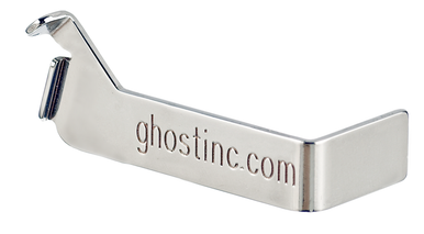

    My buddy bought a G42 via a PPT a few months back. It was in new condition. The trigger was rather heavy so he had me check it with my digital gage and it came in at 9.8 lbs. I read that the trigger should be 5.5 lbs. Can he buy a lighter drop in trigger for his 42? Is the "Ghost Edge" connector worth a shot?

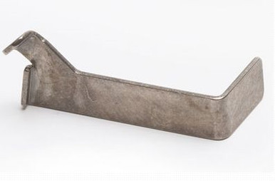

    Improve heavy trigger pull of your Glock 43 with our Double Diamond 3.5 Pound Connector. Visit glockstore.com for all your Glock 43 accessories today.

              in full disclosure I have not used the product I linked, just wanted to show you an example that on glocks it's easy enough to change that connector bar and leave the trigger otherwise unchanged. that's true with all models not just the little g42.

                I put the Ghost Edge in mine and it was a dramatic improvement in pull weight over the (early model) factory 8# connector. He could also try the Glock oem 5.5# connector if he wants to use factory part..
