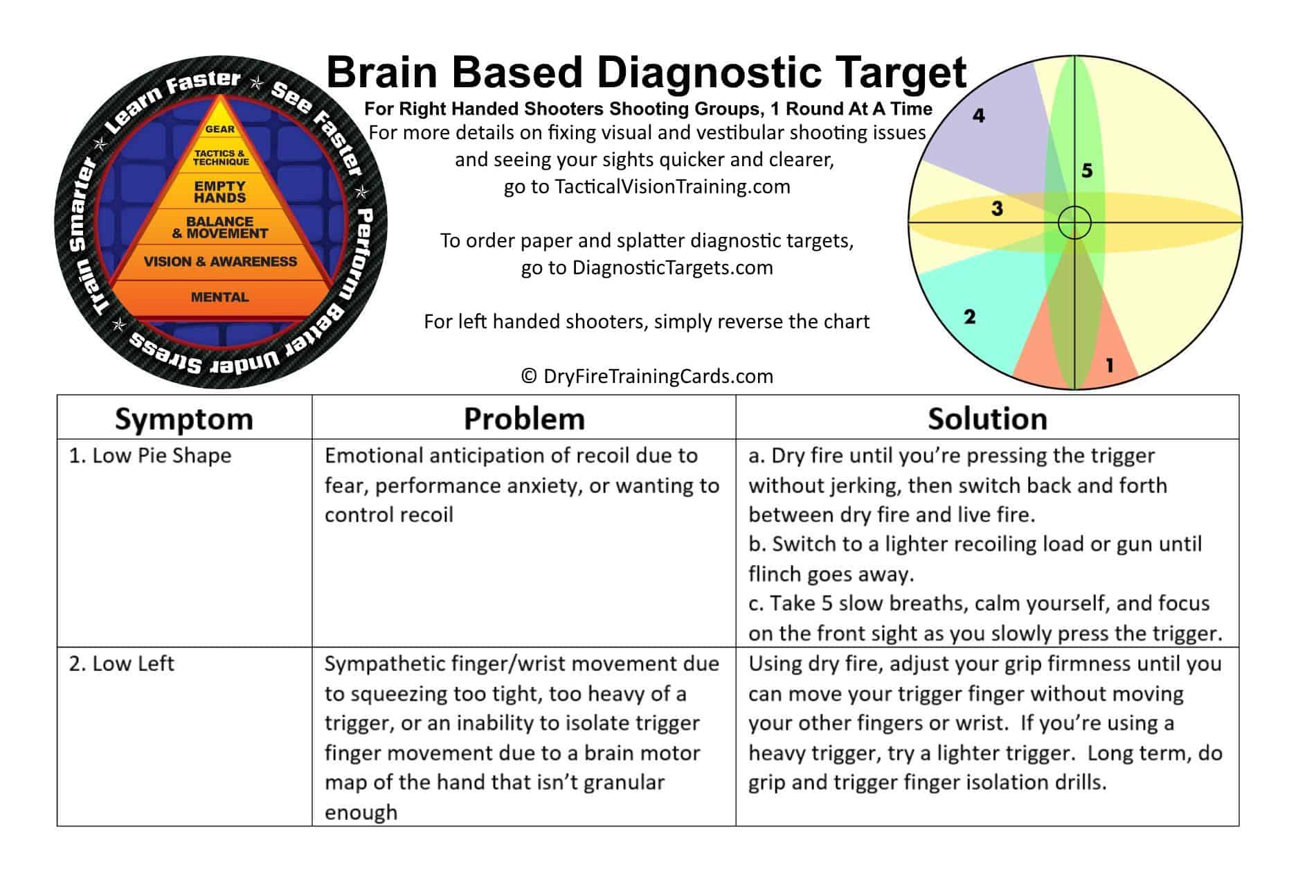

    Get a couple others to shoot them, that might tell you if it's you or not. Here's a handy chart.

        That said, there is another, seemingly new diagnostic chart out there:
