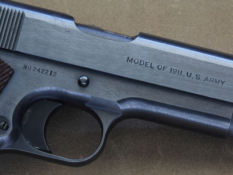

            Here is my 1918 in what is known as the "brushed blue" finish. Under bright lights that blue really stands out! This is one of my best conditioned guns (all original) in my collection.

              Fine specimen of what an ORIGINAL looks like. There are so many restoration
              types on the market today,mostly done by Turnbull. They look great but
              are not the real deal.They cost a fortune. At the end of the day they have
              0% original finish ! Thanks for sharing, Beetle.

                Originally posted by beetle
                need to post pics before anyone can evaluate. could be worth anywhere from $500 to $5000.
                I like how you say it is BLUE they sure made pretty guns back in the day.
                Now THAT'S a beauty! Very nice!

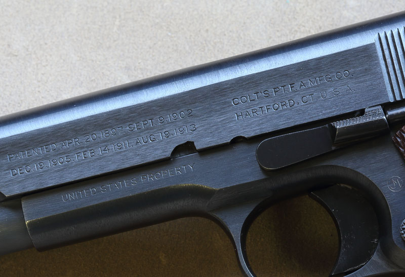

                  Somewhere around the 180K serial number range the font of the roll marks changed from the earlier style with serifs to the Gothic letters you see on Beetles gun. The style of the letters will be the same on both slide and frame, if they are different, the slide has been swapped out.
                  Here is my 1917 Colt that was made around March of that year. Not quite as nice a Beetle's, but pretty decent for a 100 year old service weapon.
                  Look at the way the grain of the polishing lines run differently on the grip frame. At the top, they run horizontally and below the mag release, they run vertically. All these early brushed finish Colts came from the factory this way. If this area is highly polished, or the grain is homogeneous throughout, it will have been refinished.
