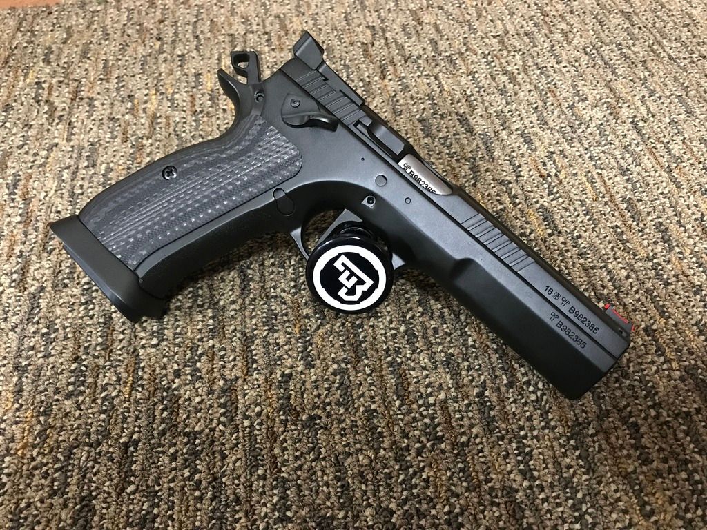

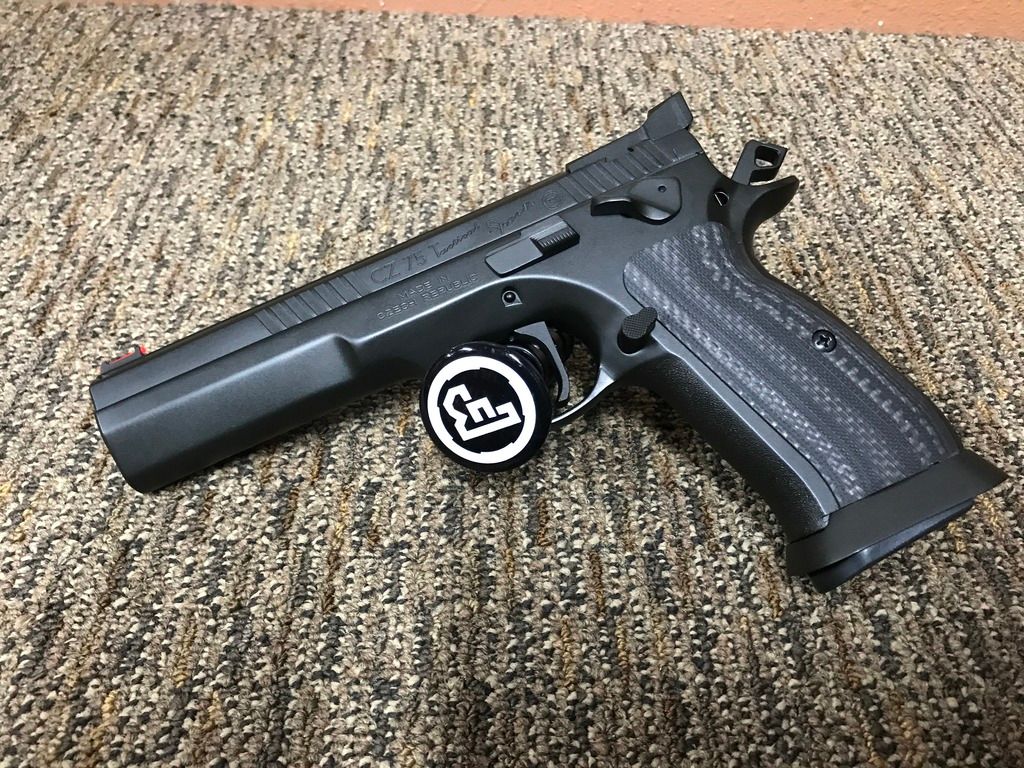

    So we all live in the People's Republic and are constantly frustrated by the handguns that we are allowed to purchase, my buddy is in the same boat as all of us, but decided he wanted a CZ 75 Tactical Sport in 9MM, but did not really like the base gun.... The following is what he had me do to his pistol to get it set up like he wanted, I hope you all enjoy!!!
    1. Removed factory checkering on the front strap, back strap, and triggergaurd.
    2. Stippled front strap and back strap.
    3. Cut slide flush to frame when in battery.
    4. Installed 10X bushing
    5. 11 degree recessed crown on barrel cut slightly into bushing.
    6. Carry bevel on the front of the slide and frame.
    7. Dehorned entire pistol.
    8. Reshaped dust cover.
    9. Reshaped factory ambidextrous safety controls.
    10. Cut slide stop pin flush to frame.
    11. 25 lpi serrations under slide stop.
    12. Machined CZ custom mag well to a lower profile.
    13. Fit and installed Cajun fiber optic front sight.
    14. Fit and installed CZ Custom Rear sight.
    15. Installed Cajun SAO trigger.
    16. Installed Cajun TS trigger pin.
    17. Installed Cajun adjustable sear.
    18. Installed Cajun TS hammer.
    19. Fit VZ carbon fiber grips.
    20. Refinish in Black-T by Walter Birdsong.
    A couple more things to do and then get some good Hi-Res pics taken of the Tac Sport. I did all of the work myself by hand and a some with my mill, thanks for taking the time to look at my work!!!

        Originally posted by offrdmania
        Very nice work! Now go out and shoot it
        Not mine to go out and shoot, I know it shoots prior to refinish, but my client wanted it unfired.

            IVC
            • 17594

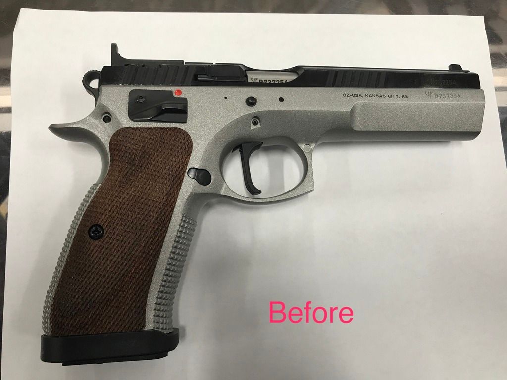

            How come the serial number changed? B73... to B98...

              hotDAAMN that's shwankaDELIC! DAMN!
              good eye on the serial number change... lol wrong "Before" pic?

                  Maybe the first picture was used as an example?
                  Regardless, I love what was done to this TS.

                    Niiice! I like how the corners are now rounded.
                    Do you have pics of the stippling on the front and rear strap? Any grip reduction?
                      Agreed. That isn't the same gun.

                        ctbassman
                        • Mar 2007
                        • 360
                        It's the same model of gun, forgive me if I used a shelf gun way after the fact to show what it started out as ended as.
                          That makes more sense. Either way, the modifications you performed are very tasteful and well thought out. Very nice!!
