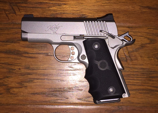

      I have one, it's actually my EDC. I've got more than 10,000 rounds through it and have come to these conclusions:
      The good:
      It's a 1911, so the trigger is as you would expect.
      It has been very reliable for me using 230gr JHP Speer Gold Dot ammunition. Have NEVER seen a failure of any kind after firing several hundred of these rounds.
      Using different powders and projectiles, I have developed several different reloads for this gun that shoot very much like the Speer GD in terms of recoil and velocity. No issues with these either.
      It's pretty accurate for a 3" gun. I can easily take down a 6" plate rack at 15 yards and score devastating hits on an FBI target out to about 30 yards. Beyond that, it's a guess where it's going to hit.
      It's easy to conceal for a 1911, leaves a minimal print.
      The iffy stuff that I would change (again):

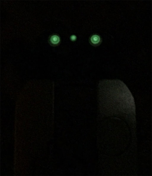

      The factory sights suck. No dots, just plain Jane Kimber sights. I installed Meprolight Trudot Night Sights specifically fitted for the Kimber and like them much better. Price varies for these, shop around.
      Kimber mags suck: Buy some Wilson Combat mags when you purchase the gun.
      Take down is weird for a 1911. You have to use a special tool or bent paper clip to remove the barrel from the slide vs just removing the bushing, spring, guide rod, etc. It's really not a big deal, but kinda funky.
      Initially, my UCII had some issues with steel cased ammo like Wolf and Tula. Didn't like it, had several stove pipes and double feed issues with those rounds, until I went to a 22lb recoil spring (up from the factory 18lb) at around 2000-2500 rounds. Once I did this, it will fire/eject/feed anything I've fed it. Polishing the feed ramp also helps.
      I had a TON of stovepipes and other issues with my own reloads starting around 4500 - 5000 rounds when I never had these issues before. After tweaking the Kimber extractor some, the problem decreased a lot, but didn't go away so I replaced it completely with a Wilson Combat direct fit version and it has worked flawlessly since. I would probably do the recoil spring and extractor straight away knowing what I know now.
      Overall:
      I like the gun, at least enough to carry it daily. Not too heavy, easy to get parts for, easy to find holsters for, and shoots well when you get a few things dialed in.
      I changed the grips to a Hogue solid grip with finger cutouts to add some bulk to it. I have big hands, so this helped me establish a more positive master grip when drawing.
      As with many guns, don't use +P ammo in this one. Firstly, there's no need for it, and secondly, it will wear out your gun prematurely.
      Some guys like Yeager will badmouth the 3" 1911s (and 1911's in general), but I've found this particular gun to be solid and reliable. YMMV. Some people love Kimber, some people hate them. I'm somewhere in the middle, but certainly more towards the "love" side of the continuum.

                    I had a Kimber Ultra Carry II.
                    It was a beautiful gun. The problem is a never ending series of FTF, just like so many Kimber owners. Even when I sent it back to Kimber, it would still come back FTFing.
                    I even had Wilson Combat mags and it would FTF on those, too, but not as bad as with the original mags.
                    People have developed many ways to make it work well, some are right here on this thread.
                    But for me, the magic trick was relatively simple. I ditched the original mag. I ditched the Wilson Combat mag. And I got myself the Kimber KimPro Tac mags. This is all that was needed to make the gun work flawlessly.
                    Hope that helps, good luck.
                    Picture (I had two of them, the other was the SIS model. Runs flawlessly too with KimPro Tac mags and a 22lb recoil spring).

                      Just FYI - The California compliant version of the Eclipse Ultra II has Meprolight Night Sights on it as OEM.
                      Performance has never looked so good. Kimber Eclipse pistols have a striking brush-polished finish and special Custom Shop features, including 30 lines-per-inch front strap checkering and a Premium Aluminum Trigger.These select models of Kimber pistols are designed to meet the strict California compliance requirements featuring high visibility loaded chamber indicators. However, these pistols are available in all 50 states for individuals looking for additional safety attributes to classic 1911 pistol designs
