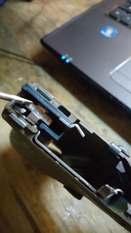

                  The sear is the back slant on the trigger bar. You want to polish the rear of the firing pin and face of the back part facing the inside of the slide.
                        this part where pocket screw driver is pointing ? I would try to polish other area you mentioned as well .
                          shafferds
                          • Feb 2008
                          • 1970
                          Yes however do not round that edge.
