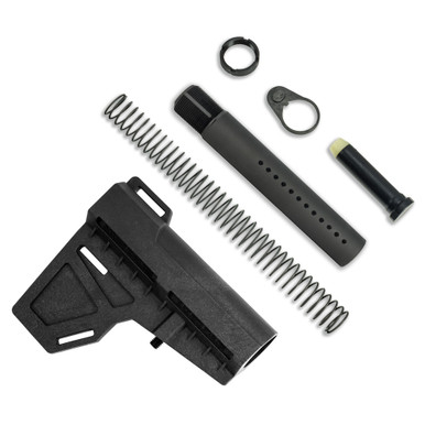

        You can be like one of the cool kids and get one of these:
        Get the complete Shockwave package in sleek black, including the Shockwave blade pistol stabilizer and matching tube, for enhanced firearm control and stability. Upgrade your AR-15 pistol build with this high-quality package.
        AKA the bullet button equivalent for AR Pistols.

          I personally think the KAK shockwave and the SIG brace are also riding the line, approved or not but that is again just my opinion, gives a R/O or LEO just another reason to walk up and ask questions. Anyone that has used one or seen one in person may agree. For me it is only a tube and foam cover or a thordson cover and a cheek riser/rest only. Plus for active shooters that foam on the cheek actually works and gives you a nice steady aim.
