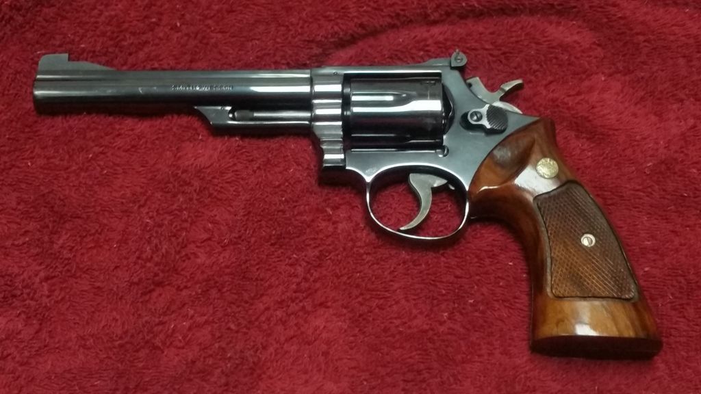

    I purchased this S&W just over 10 days ago after it was posted in the Marketplace for sale as a .357 Magnum 15-3. Several people asked for an update once I picked up the gun, so here's a few photos and what I've found.
    Here's the link to the sale ad: http://www.calguns.net/calgunforum/s...highlight=15-3

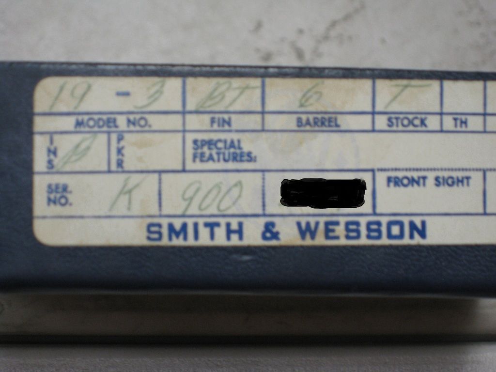

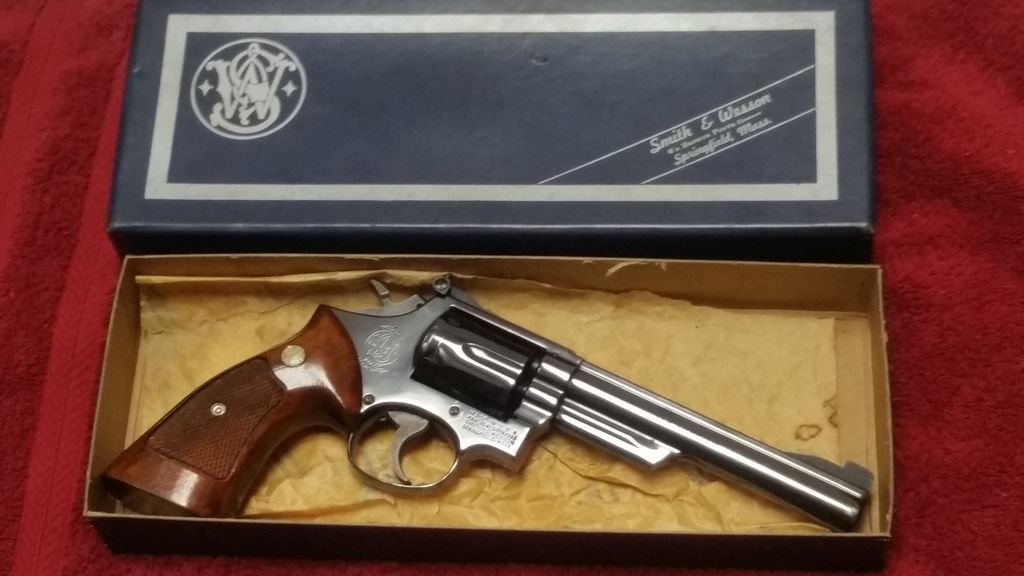

    There was much discussion about it as the seller didn't immediately post pictures and he wasn't familiar with the S&W models and calibers. Many suspected that the gun was pieced together from various parts. I didn't know myself but decided to take a chance on it and meet the seller for a PPT. As I updated in the original sale ad, I was surprised when the seller showed up with the original box for a 19-3, with a matching serial number to the "15-3". Everything looked very good with the gun, and I concluded that it was in fact a 19-3 which had been mis-stamped by the factory as a 15-3.
    My 10 days was up yesterday, so I now have it home, cleaned it up, inspected, and taken a few photos.

    The Serial number on the box matches the serial number stamped on the frame. The label reads "19-3" in the Model box. The other end of the box reads ".357 Combat Magnum Blue Finish Model 19 6 inch barrel.

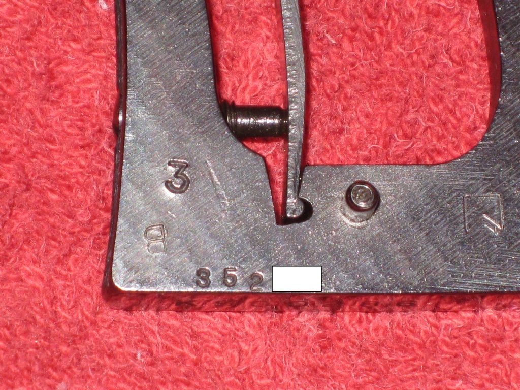

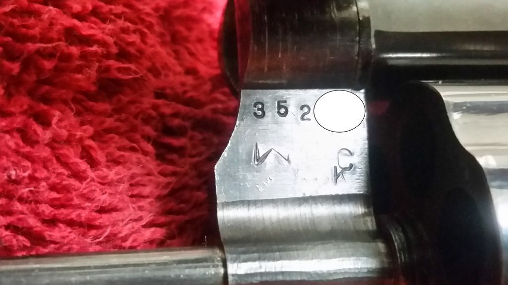

    In any case, the serial number inside the frame matches the serial number on the bottom of the grip frame, which matches the serial number on the box, and the model stamped inside the frame clearly reads "15-3".
    There is a "3" stamped on the lower left side of the grip frame which indicated that the frame was intended for a .357 Magnum gun.

    There is a 5 digit number stamped near the bottom left side of the grip frame which I assume is an assembly number of some sort. There is a matching number stamped on the yoke.

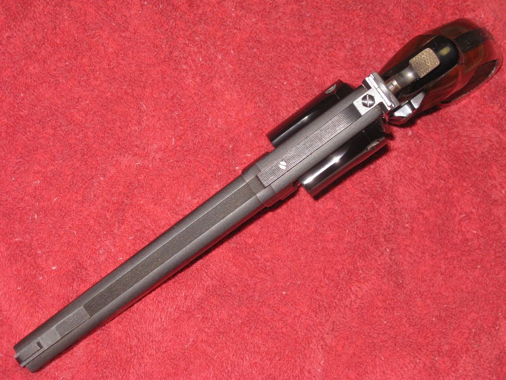

    The barrel is pinned to the frame and stamped S&W .357 Magnum on the right side.
    The cylinders are recessed and a .357 cartridge chambers properly in all cylinders.

    Beautiful gun. It's definitely not a model 15. It is a 19. I have a 15 and a 66, which is the stainless version of the 19.
    The shroud around the extractor rod is for the 19 or 66. The 15 does not have it.
    There should also be the complete serial number on the butt frame under the grip. On some models, the serial number on the yoke area of the frame is a partial number, along with the model stamping.

      Thanks Ron, finally got photobucket to work so I posted some more photos. Yes, the complete serial number is on the bottom of the grip frame as well as in the yoke area, as well as the "15-3".

          I think your hunch is correct that it is a 19 with a mis-stamp.
          The features dictate that it is a 19, especially the shroud on the extractor rod. 15 doesn't have that.
          Most 19's also came with target grips, like yours, while 15's typically came with magna grips.
          A 6" 15 is also very rare as it is normally a 4" revolver. Its 6" counterpart is the 14.
          If it was a frankenstein Smith, then it looks like the person who did it is super highly skilled. I doubt it.

                    Mis stamps occurred with S&W on occasion. Great looking K frame. That
                    was a good price also. The 5 digit number in the yoke is usually an
                    assemblers number(not related to the serial) that number should be
                    on the frame and on the inside of the side plate,they are usually all
                    the same number FWIW! Pete
