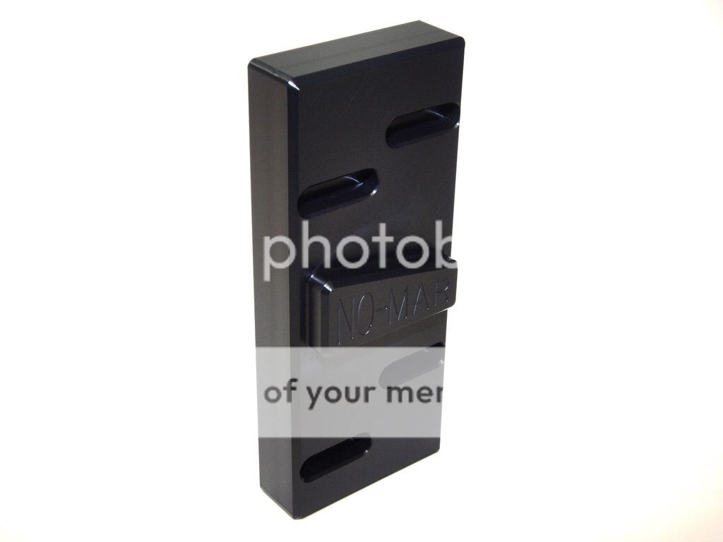

                radicalray
                • 450
                Use vise block 9.99
                CNC cut NO-M.A.R® polymer protects receivers finish. NEW Multi-Lock® feature locks receiver in ANY Position! Install through top or bottom of Magazine Well. Works with Upper Receiver installed or removed. Provides Access to Trigger Guard, Pistol Grip & Buffer Tube. Compatible with our Trigger Buffer Block. Makes Trigger & Safety Installations Much Easier! Works in Any Bench Vise Large or Small. Built in Support puts No Strain on your Magazine Release. Universal Fit works with any 223 AR15 Lower Receiver, Great when Combined with our Upper Vise Block !
