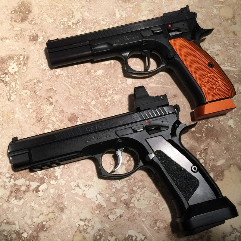

                Here's my CZC CTS SP-01 Build:
