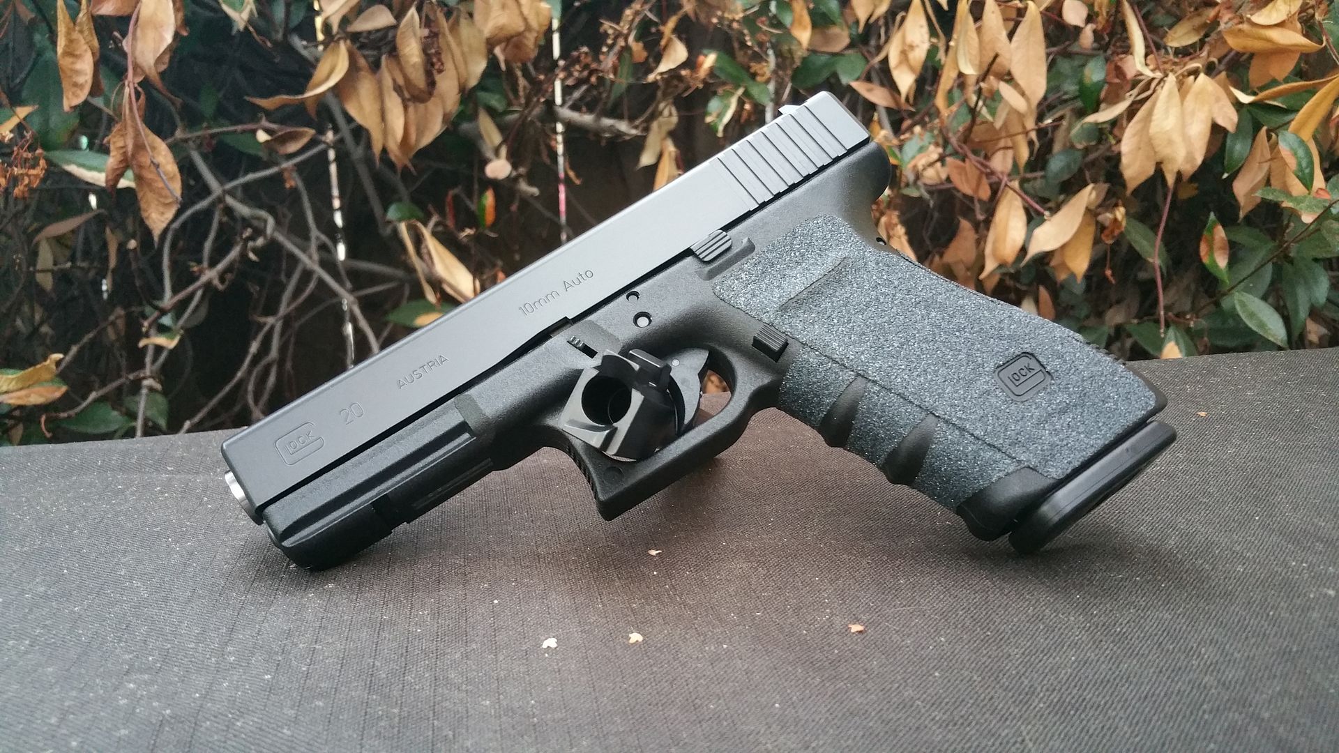

    TL;DR: I bought a 10mm Glock 20 SF. Check out my pics.
    So I've been thinking about 10mm ever since I started handloading. The round is appealing to me as a fun, fairly hard-hitting round then has a very high marginal savings when compared with factory, off the shelf ammunition.
    As a non-exempt person, your 10mm choices are awfully limited. On roster choices, it's Glock or Kimber. Even if you wait around and try to PPT on of the "other tens," you pay the off-roster premium - which I really struggle with. I'm buying this as a shooter, not a display piece. If I felt there was something better, worth the premium, then I would consider it. But if the masses are any indication, the 10mm world loves the Glock.
    This leads me to my choice: a Glock 20 SF. I'm not a huge Glock fan, honestly. They aren't much to look at, and every model pretty much looks the same. It is a tool that lacks much of the character of some other fine firearms. But they just run. It takes a lot to kill a Glock and especially with the 10mm round choice, I want a platform that could take a long-term beating of stout full-house loads.
    I already own a G19 with some of the basic mods. In my case, it's a range toy that also serves double-duty as my HD. If I ever had to use it for defense, I wouldn't want to get into the trigger modification arguments. It has talon grips and dawson sights. That's it for that one.
    I realize as I am typing this that I never took a picture in fully stock form. Oh well, I think by now everyone here knows what a stock Glock should look like. Now on to the fun stuff.
    Step one was to add talon grips. Some people love 'em, some don't. I personally like having a strong purchase on the gun and feel the gen 3 stock grip is fairly slippery. Again, especially with full-power 10mm ammo, I want to hold on.
    You hear members of this forum and others mention "glocked" brass or a "glock smile." While a certain looseness in the chamber support department can make for a reliable, fighting gun that Glocks are known to be, it also creates a chamber support issue for someone like myself who intends to re-use the brass many times. Even with certain tools to remove the glock smile, the case will never be as strong where the brass stretched. That's just a fact. Queue a lone wolf barrel. Better chamber support and the ability to run cast bullets, should I ever get the inclination. Not that this is a reason to get another barrel, but I think the black on silver look is pretty slick too.
    To properly cycle and eat full-house 10mm loads, I need to address the recoil spring. You probably could just leave it alone, but the spring is fairly light. I don't need to beat up the slide of the gun unnecessarily, and my brass would fly into another zip code. I went with the stainless guide rod and a 24# spring from the lone wolf sight. Seems that many of the 10mm guys suggest either a 22# or 24#. No pics of that specifically, but it is installed in the pic above.
    That's all for now. I just picked her up this past Monday and will get a chance to take her to the range first thing tomorrow morning. I've bought a couple boxes of underwood to run through and will also be working up a ladder of my own 10mm to test out. Here she is as she sits. You can see I really put that stock barrel to good use .
    More to come... I plan to address the sights, maybe some trigger parts, holster, accessories, etc. after I put some rounds through her! Also a range report to come over the weekend after I run 'er through the paces.

    Range report:
    *As usual, any handload data is at your own risk. These loads are, at times, above published load data. Work up your own loads and stay safe out there.*
    I spent a couple hours at LPRG (Livermore) outdoor range this morning. Fired 40 rounds (18 handloads, 22 factory rounds). The factory ammo used was two different varieties of Underwood (180gr FMJ and 200gr hard cast). The 180gr are rated at 1350 FPS and the 200gr hard cast are rated at 1250 FPS. I do not have a chronograph so I cannot speak to the accuracy of these claims. My first thought - these seem pretty stout. The only other 10mm rounds I have shot were a Hornady defense round (do not remember bullet weight or specifics). This was done out of a G30 with a 10mm conversion barrel (effectively a G29). While the Hornady's were decently hot, the Underwood is much hotter, even out of a longer barrel and heavier gun.
    My goal is/was to replicate hot factory ammo with my handloads. I do not feel any need to shoot watered down (basically .40S&W) rounds. To me, this purchase was a toy designed to be as much of a hand-cannon as the round was originally intended (Aside: I would, one day, like to find some old 80's era Norma to see what those loads are like...). After firing a couple of the Underwood rounds, it was time to start testing the ladder of handloads I brought with me. Again, work up your own loads and use my experience at your own risk.
    I grabbed the 500 pieces of new Starline brass I recently purchased, fired up my 550B with some Power Pistol and got things going. I've been using Xtreme copper-plated for my handloads in other calibers, so I decided to give their 180gr pills a go here as well. I started at 7.8gr and built a ladder up to 8.9gr. Anything below mid 8 grains felt lighter than the Underwood. I believe these can go a bit beyond 9 grains, based on my "butt dial" feel of the 8.9gr I built up. Again, this is all without a chrono so if I decide to push it much further than I have so far, I think I'll either make the investment or borrow one from a friend. When comparing my loads to the Underwood, I think they are still a bit stronger than my loads. It's close enough that I need to start going to the figures. By feel alone, it's close. I don't intend or desire to blow my hand off, so I'll probably stick somewhere between 8.6 - 9.2 gr from here on out. I usually stick to published book values, so this is fairly new territory for me. I have no pride of authorship, and would have gladly torn down the rounds I made if I felt any sense of foul-play or over pressure signs.
    So that's a lot about the rounds I fired, but how about my experience with the pistol so far? Well don't get me wrong, the gun has some recoil. That being said, with the heavier recoil spring (and being used to a G19 sized frame) I felt the gun held its own very well. The brass did not eject into another zip code, and I did not feel the gun "bottoming out" like I feel it would have with the stock (18lb I think) recoil spring. I think I made the right choice jumping all the way up to the 24lb spring.
    Another claim I've heard a bit on this forum and others is that an aftermarket barrel can cause failure to feed issues with a Glock. The tighter chamber relative to the stock Glock barrel means flat point or hollow point rounds can more-easily be stuck on the feed ramp and cause the weapon not to go into battery. No such issue here - the lone wolf barrel and pistol in general performed flawlessly.
    In the accuracy and point & feel departments, the Glock is like any other Glock I have shot. My G20 is as accurate as the goon with his booger hook on the bang switch. Some moan and grown about the Glock grip angle, but I find Glocks to point just fine. I've made my overall Glock look & feel comments before, so I'll save you from that again, but in general the gun did everything I expected and more.
    More info to come after I take her out a few more times. And more updates as I think more about upgrades and accessories to add for this pistol. A fun day at the range, no doubt.
