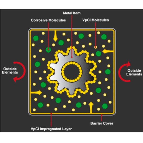

          ZCORR Anti Corrosion Velcro Pistol Bag @ $8 a pop. I would vacuum seal 'em and throw in a dessicant + o2 absorber for overkill measure. Claims up to 20 years corrosion protection.
