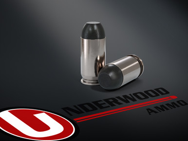

                        OK so i started to look up the 45super/10mm ammo available from underwood or Buffalo Bore. It seems every where ive read, its best to use hard cast bullet for Bear or large animal etc.
                        Well in California we need lead free ammo. So even If i bought that, and just so happen to need to use it. I will be in trouble for shooting lead ammo
                        So the lead free solid copper stuff seems to be hollowpoint, which from my readings, would not be great to penetrate bears right.
                        like this https://www.buffalobore.com/index.ph...duct_list&c=98
                        Then there is hard cast bullets like this but they have lead.
                        Underwood Ammo offers the most comprehensive and innovative Underwood Ammo™ Supersonic Handgun Ammo for personal defense & hunting. Shop now .45 Super Lead ammo with Hi-Tek Coated Hard Cast.
