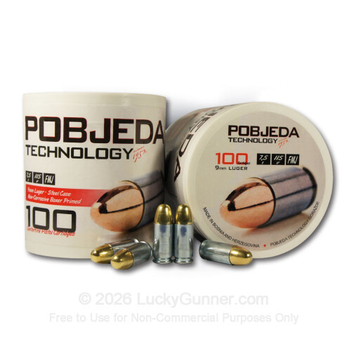

    Yes, that is actually how it is spelled. Made in Bosnia...
    Ok folks for lack of finding a better forum to put this in here it is:
    Got a Sig SP2022 9mm. Been feeding tons of stuff through it to include weird stuff and steel. Has always been performing perfectly and very accurately. Maybe 1500 rounds through it and love it. Even when dirty...
    So... I bought some of this Pobjeda ammo. Hey they had a sale so....
    This stuff will not extract. When it fires it will eject just fine. Just not extract.... And not only is this a Sig but it is VERY clean.
    And this is ONLY this gun. Works fine in Springfield, Glock, High Point, etc. Just not this gun.
    WTF? Any ideas?

                      Check out the reviews on Luckygunner
                      Poor Quality Ammo Review by VP9er
                      Value
                      Quality
                      Performance I've put 300 rounds of this ammo through my VP9 and have had several FTE's. Very frustrating on the range when you have to pull out your Gerber to pry out a spent casing every other magazine. I do not recommend this ammo. (Posted on 3/30/15)
                      Ammo jams more than with any other ammo I have used Review by Hawk
                      Value
                      Quality
                      Performance I have not had more jams or casings caught in the gun and not ejecting with any other ammo. Both my Smith & Wesson and my Ruger suffered from jams with this ammo that I have not experienced with other 9mm ammo. I shot maybe 300 rounds of my 1,000 round purchase before getting rid of the remaining ammo. Would never buy it again and will stick to brands that I know and have confidence in. (Posted on 1/28/15)
                      Bulk 9mm 115gr FMJ steel cased ammunition for sale online at LuckyGunner - Probjeda Tech Ammo - 1000 Rounds
