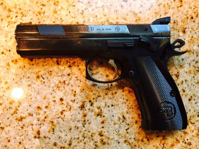

    CZ 97BD problem
    I'd like some advise from the CZ experts here. I just picked up a NIB CZ97BD after 10 days of DROS. I bought it home and realized that i can't reach the trigger in DA trigger position. Small hands here. I called Scott at CGW and was told that his Pro package upgrade would give me a trigger travel reduction by 5mm besides other features. Would 5mm reduction make a big difference? The trigger is quite heavy too. I pretty much have 3 options
    1. CLP and try it stock at the range
    2. send it to CGW
    3. keep it unfired and post it back up on Calguns. I'm reluctant because it's not very day that i can get an off roster NIB CZ 97BD in Cali here.

          I installed the RRK on my 97B. The trigger has a set screw to remove pre travel in DA plus I installed a hybrid T1/RRK disconnector that David custom cut for me. It shortens the static position of the DA trigger and also changes the geometry and leverage of the trigger pull. The DA trigger pull is shortened as well.
          Static DA position without the RRK
          With the RRK trigger and hybrid disconnector.
          SA static position with the firing pin block removed and FPB lifter arm replaced with a spacer in combination with the hybrid disco. For the decocker version you would have David custom cut a hybrid T2 (retains FPB) disconnector to have the RRK and short reset.
            Jimvh2
            • 688
            I knew that someone who knows a lot more about CZ's than I do would be along to help.....
            I really like the Glossy blue finish.
            CAGLS, what sights do you have on the 97 you have pictured?

                          CAGLS
                          • 3778
                          CZ 97BD problem
                          Thanks, it's the CZ Tactical rear sight standard dovetail I got from CZC.

                              Strykeback
                              • 1574
                              Wow now that's sexy!
