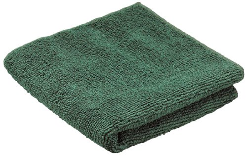

                            Egg crate foam is a no go. Get rid of it. Use a dish towel or something in place of it. Use a Rem Oil cloth on top of that - and set the gun on the rem oil cloth. The Rem Oil cloth has moisture guard and VCI.
                            Wrap + tape pure silica cat litter in a coffee filter and keep it in there too.
