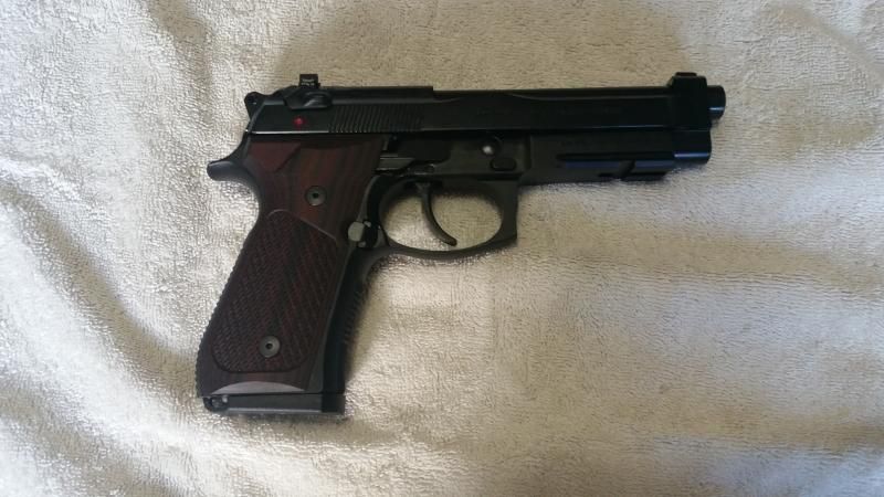

So far, I've installed a Wilson Combat short reach trigger, and the DSpring on my 92G-SD, and it feels really nice. I tried a mild polish on the trigger components, but not sure it did much, as I was probably too mild.
I have an Elite II skeleton hammer on order, as well as a WC fluted guide rod, and will install when I get them. I'll definitely polish the hammer and sear when I do the install.
