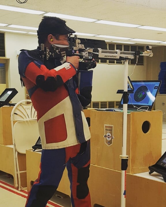

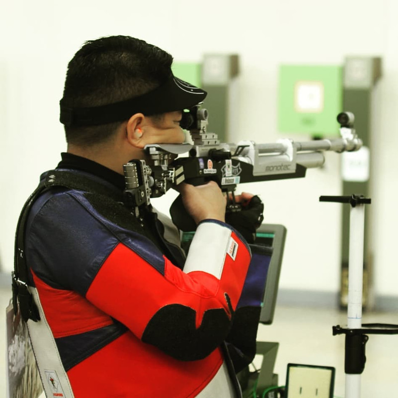

                            ChampCarStar
                            • 605
                            Originally posted by ejhc11
                            Yep that is the newer model series 800. Mine is the 700 and around $1800 back then. The trigger is in the ounces. You almost let off by just thinking about it..! Yes, when you miss, you can't blame the equipment on these type of airguns.
                            $1800 is cheap for an air rifle of that type nowadays. The top of the line Feinwerkbau currently is the 800X. Which can be found for just under $3000.
                            I've owned Anschutz, Feinwerkbau, and Walther air rifles. But I was an athlete with USA Shooting for several years.
                            My current rifle is the new Walther LG500 Monotec seen below. I received one of the first ones to come to the USA. Great rifle, but at $4000 it better be.
                            Getting this type of rifle only make sense if you're actively competing and trying to make the Olympic Team.
