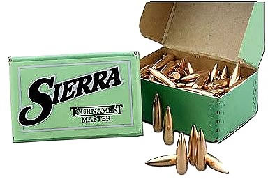

                      Bullets:
                      Sierra 338 250g HPBT- $21.26 / 50 ($0.43 Per)
                      http://www.midwayusa.com/eproductpag...eitemid=871533 (29.99)
                      Sierra 338 300g HPBT - $30.56 / 50 ($0.61 Per)
                      Shop premium reloading components, smokeless powder, primers, bullets, and brass at Powder Valley. Best prices, free hazmat on qualifying orders. Shop now.

                      So, I figure you can get it down to $1.00 - $1.25 per shot, based on reloading and the research above. You can drastically reduce bullet cost by buying them in bulk, 500+. Same with the LAPUA brass, if you buy 1000 units you save about $150 (only about $50 if you buy 500).

                        Bullets:
                        Buy them 500 at a time for a better deal.

                            Originally posted by edittman1
                            Regarding the barrel, it is 1/10, but what would be an ideal bullet size to start with? 250gr?
                            Oh yeah, thanks.
                            If it is 1/10 might as well use the 300, they'll get you out further (that is if you can find a range to get you that far).
