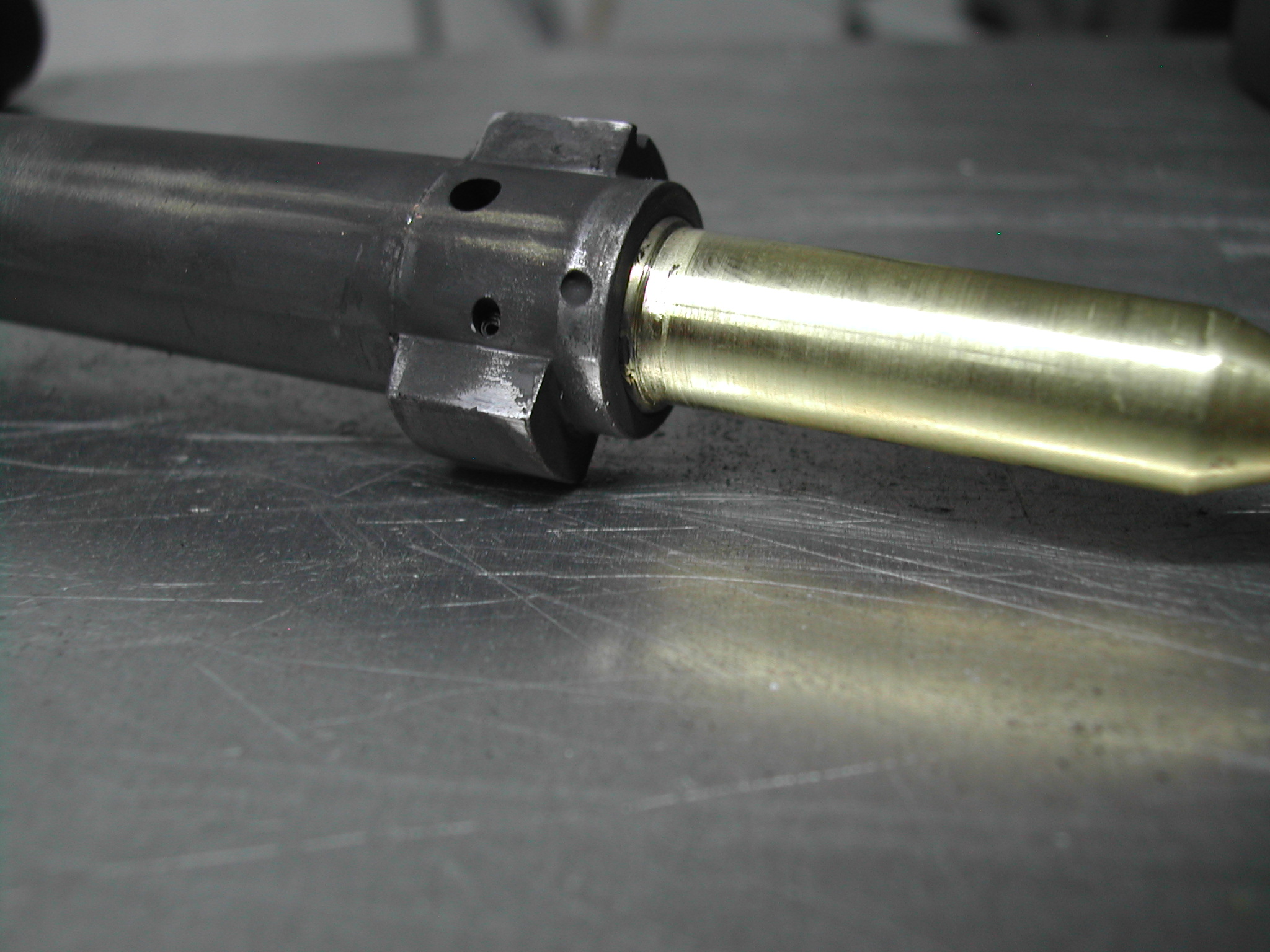

    Exactly the vents in the bolt were to vent gas when you popped a primer common with the hotter loads.
    Leave a comment:
  • ar15barrels
    replied
    The vents in bolts are ONLY to deal with gas that enters the bolt through the firing pin hole.
    No amount of bolt venting will stop the gas/debris that exits the chamber in other places than the firing pin hole.
    When you reach that point, you have done something REALLY wrong.
    Some designs handle that much better than others.
    The more open the bolt face, the more places for stuff to get out of the chamber during a high pressure event.
    Controlled feed actions are some of the worst at handling high pressure events.
    Fully shrouded bolt faces handle high pressure events the best.
    Leave a comment:
  • LynnJr
    replied
    SigStroker
    That post was from James Calhoun fine shooting bullets because my picture taking skills are horrible.
    The drilled bolt has been around for longer than me and I am as old as dust.
    In the old days before everyone sued everyone when you had a problem people figured out a cure unlike today.
    Leave a comment:
