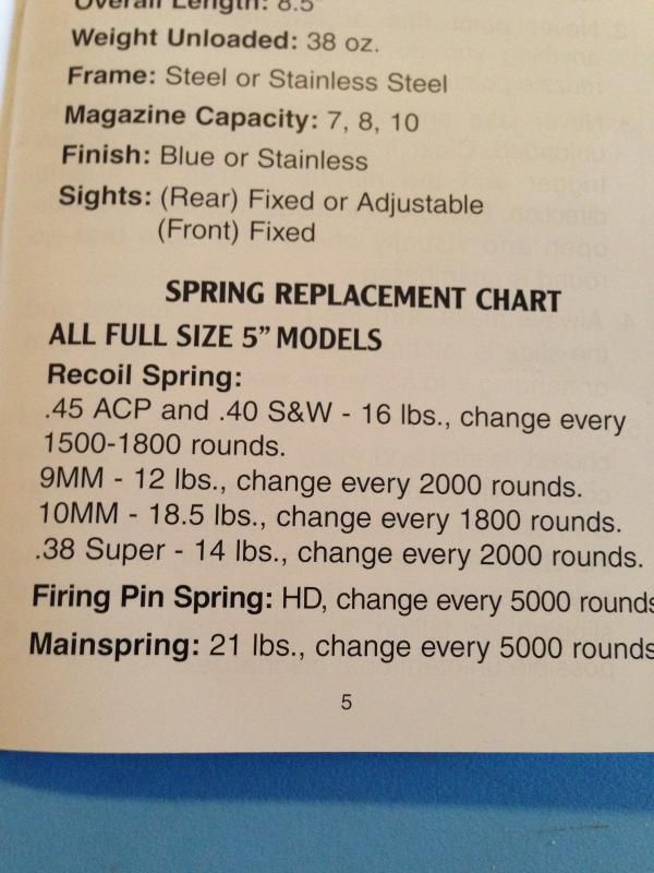

                This is what one of my kimber owners manual says.
                Similar to owning a car. Your paying for gas to drive it. In between certain miles you gotta replace the oil wich doesn't cost a lot. Do the same with the gun. Luckily springs are cheap.
