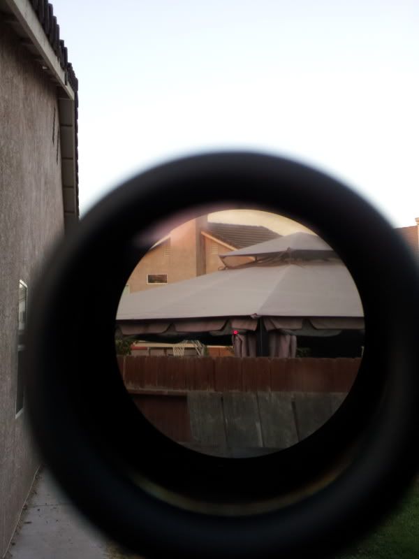

Default Picked Up An ACOG for Cheap, and....(B4 and After Pics Added!!!)
I noticed something about the illumination. It seems that compared to my TA31, which is maybe 2 years old, it is not as bright. The model is a TA44-5, which is a 1.5x16 powered Dual Illumation (tritium and fiber optic) with a center Amber dot. Sweeping the house (lower light) basically doesnt make the reticle glow very bright, and is near invisible against lighter backdrops....even when under a ceiling light. Against black/dark backgrounds, it does "okay", but still not great. About the only time it does well is in either complete blackness (tritium is obviously okay) or in direct sunlight (very bright against any backdrop). Any indirect light causes the reticle to go in that "in-between" brightness, where its extremely dull. My TA31 with a red chevron, however, shows up a LOT more bright against pretty much any background in the house in any lighting situation. Daylight is perfect and so is pitch black. About the only situation where it doesnt work out well (for all ACOGs) is when you are under shade and looking into bright sunlit areas.
So my question is, knowing that the Fiber Optic brightness never dulls out over age like tritium does, why would it be dull? The plastic on the fiber optic is clear, no cracks....the only thing I can think of is the fact that the fiber line is shorter than the TA31 and the fact that it's Amber, not Red, which can blend in with certain backgrounds.
Any ideas? Is this something that I should address with Trijicon? There is some dust on the inside of the lens which needs to be cleaned out, so I was thinking of sending it in anyways and let them know about the dullness issue to see if they can fix that too. I have no experience with Trijicon's CS though.
Any ideas? Is it just the Amber color? Or could there be a bigger problem?

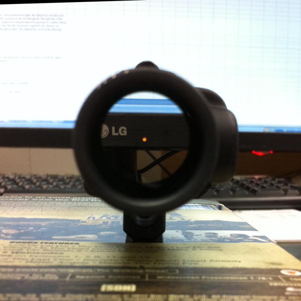

Some a quick pic from my phone. The pic shows the dot color/brightness. This is under 4 bright white florescent lights on an 8ft ceiling and it only shows a dim orange color. If I put the dot on a white background, you basically cant see it.

wow...no way that is utilizing all the potential light energy...something is wrong.

Thanks for the pictures... I can see why you are questioning the fiber tube now... I think it should look brighter than that.
Call em up and see what Trijicon has to say. Send them the picture too.

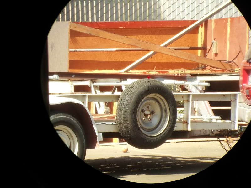

I posted some pictures in this thread a few months back to help a member see how good the eye relief was on the TA45-2 was/is.
http://m4carbine.net/showthread.php?t=102167
Without bright sunlight or relatively dark skies, the ACOG illuminates about what you show.
Completely normal, IMO. I wouldn't send it in, but that's me.
Hope those pictures help.
Tom

For reference, here's mine at 6 years old:
And from a dark room looking into bright light

Just got it back today! Here's the updated pic comparison. Same light, same spot, same camera, no Photoshop or anything other than a crop and resize. BIG difference, and even more so in person.
Before:
After:
__________________

That looks right.
