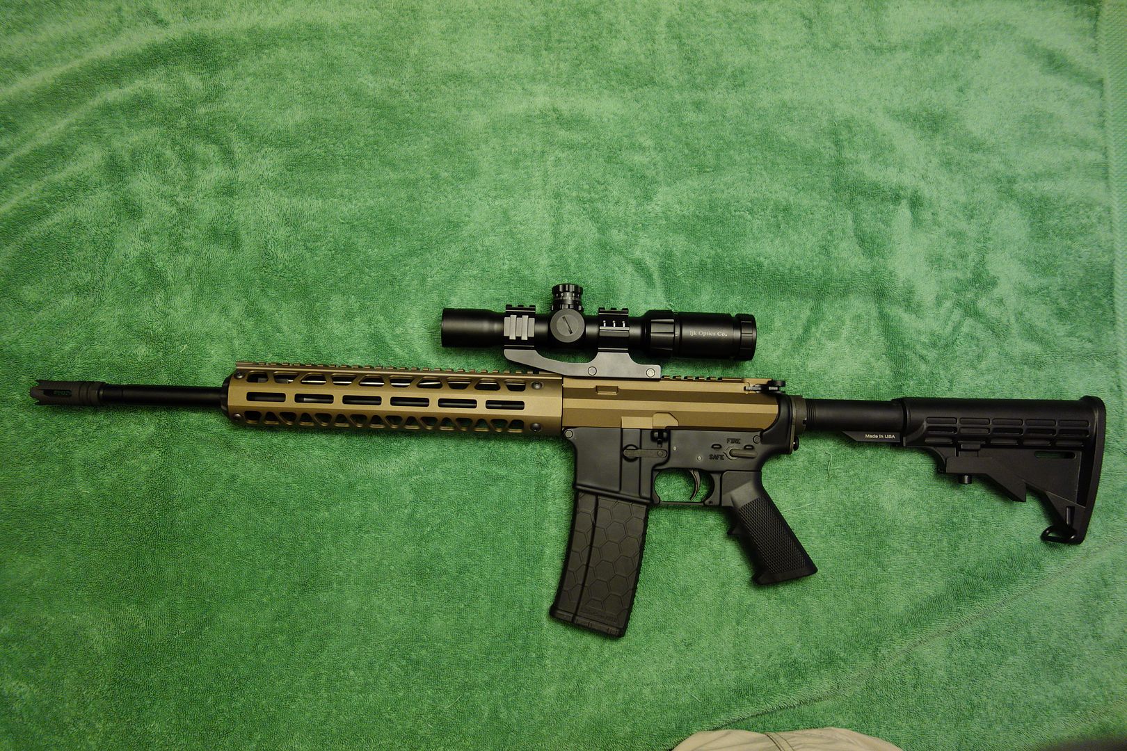

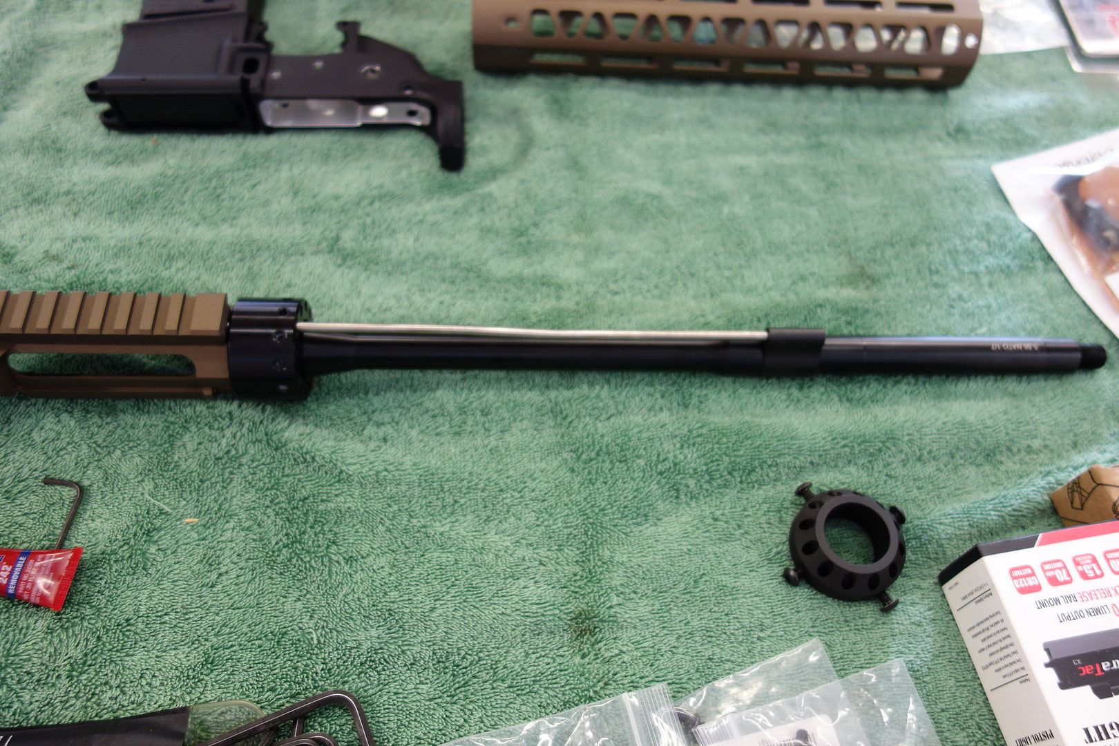

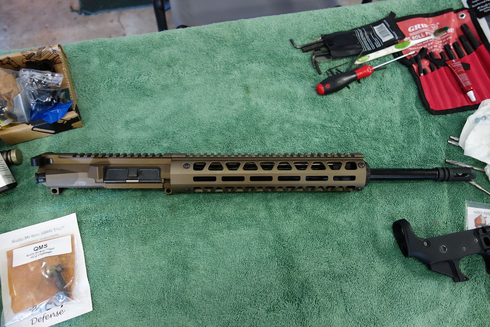

First AR build...
I found the tips here very helpful as well.
I've been collecting pieces and parts for a year and finally put it together over the weekend with some help from a buddy that's been through it already. He was a BIG help in making sure I wasn't chasing little springs and pins that got away.
I read this after I got my barrel - likely would have got a 1:9 twist instead of the 1:7. For plinking it should still be fine.
I would like some folding sights and a red-dot instead of the cheapo scope. And a cheekpad type stock. Maybe something for a forward grip, a magpul slope or a bi-pod grip.
The only missing part we ran into was the little spring for the ambi-bolt release lever. Took a few hours and was way fun and educational. A great experience!

Yes, got a set of magpul folding sites, first sight-in coming up Wednesday - will be out in Panamint Valley.
Got the little spring for the bolt release but that doesn't seem to work right - will see what it does with some cycling and empty mag. I have a feeling the bolt has to rotate or something on recoil on the last round. <shrug>
Anyway, thanks for all the good info. Think I will pickup a couple of stripped lowers - they are so cheap now, and build a couple more. I want a very basic A4 type carbine style, maybe something else as parts come up.
It's a very versatile platform.

Quote:
Originally Posted by Darryl Licht View Post
Just curious...
That scope looks a lil too far forward, what scope is that, and what is the eye relief on it?
Relief is fine, it's a rifle scope - one of those cheapies from IJK or whatever - the folks at the gun show. I bought it for a 22LR but thought I would try it on this. Turns out it actually works quite well. Just not sure how it will old up under fire, so to speak. If it breaks down I think they warranty them. Anyway, I want a AR22 and will put this scope on that for plinking.
First fire last week in the dez, way fun and the rifle works like a champ. 50yd sight-in for the scope, magpul folding sights, and a new Vortex Strike-Fire. Can get a group at about 2" if I'm really steady (I'm old LOL).
The red-dot is the shiznit for sure - could hit a 6" target at 100-150yds with it - one of the steel swinging ones.
Ambi-bolt release does not work with this upper - the lower surface of the upper receiver sticks out too much so the lever can't come up high enough to catch the bolt. It's a Billet-80 custom, so it's not mil-spec in that area.So I'll put my standard release lever in there for now and when I built a new gun I'll put the new upper on this one, use the non-ambi release in the new lower with this upper.
Anyway, super happy with the way it works, it's way fun to shoot, and the satisfaction of building my own is just fantastic. Put a couple of hundred rounds through without a hickup, 55 and 62 grain, some new, some reloads. All worked just fine. Will post a few pics when I download them.

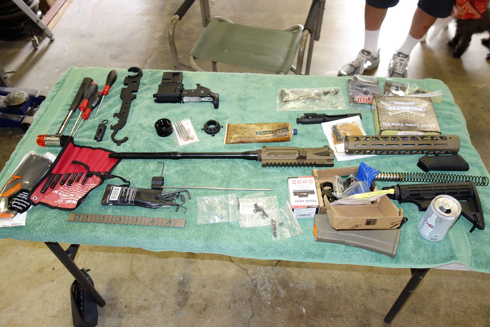

AR Assembly Tools
Another inmate was asking about custom parts and building his first AR and I talked some about tools to put it together. With some pointers from experienced builders and having gone through the process these are the very basics.
They are cheap to buy on amazon or your well-stocked dealer or other online source, and makes the difference between easy success and giant headaches...
Pin punch set: http://www.amazon.com/Grip-Roll-Pin-...7WMFHYB11F14R5
Armorers tool: http://www.amazon.com/NcSTAR-NcStar-...ilpage_o00_s00
Fits all the special nuts and pieces while assembling.
Hollow end start punch for pins: http://www.amazon.com/Squirrel-Daddy...ilpage_o01_s00
Makes starting roll-pins WAY easier. You can do them without, but for $10 makes the job SO much easier.
Barrel vice blocks: http://www.amazon.com/NO-M-A-R-Purpo...ilpage_o03_s00
You need one of these to torque the flash-hider on the end of the barrel or to hold the barrel for assembly.
Lower vice block: http://www.amazon.com/Flagaway%C2%AE...=sr_1_1&sr=8-1
This makes holding the lower or the assembly in a vice way easy for working on it.
And an upper receiver vice block would have been a real advantage as well - we were able to use the barrel vice blocks to hold the upper while torquing the barrel nut, but it kept slipping out. We got the gas tube lined up finally, but it was difficult. An upper vice block is about $30 and well worth it. I'll be getting one for my next build. Oh, and don't forget to insert the pivot pin for dust cover before the barrel nut goes on - it's what holds the pin in. Yep, had to take my barrel off and reinstall it. LOL.
Oh, and set of SAE allen wrenches especially for putting together the guard and associated bits, rails, etc. The grip handle requires a long-ish one to reach the bolt that holds it to the lower receiver.
I did not use a torque wrench - I have a good feel for torque values having wrenched all my life, and on my build the barrel nut has to be clocked for the gas tube to line up so once you get it cinched on there's a range of torque values to accommodate the proper alignment anyway. The armorers tool was invaluable for this process.
Hope this helps!
Hope this helps!

Default
Well, more like a AR noob, but thanks. I'm a quick study.
Nice to see people getting into the build aspect rather than just go buy one.
Looking for suggestions on a second build.
BTW, what does the group think about Lucid HD7 red-dot?
On sale for $150 today at Primary Arms.
__________________
1911 Shooter

Recommendations?
As far as a new build, I like these Diamondhead guards. I'm not sure what else I might want different. Perhaps build to a need, like rugged field use, or long-distance sniper fire - like a 20" SS barrel or something.
I can't see changing calibers, the 223-556 works just fine for what I want to do with a rifle.
