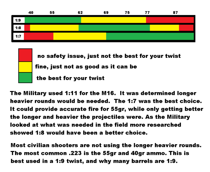

What twist rate is good for me?
The longer the projectile, the faster the twist is needed in the barrel. Nowadays, the most common rate is 1x9 (one twist per nine inches), which is optimal for stabilizing 55 grain. 1x9 means the barrel will make the bullet turn nee full revolution (twist) every 9 inches. This twist rate will adequately stabilize a projectile up to 62-69 grain bullet but may have trouble with the heavier/longer 75 grain and up bullets. I cannot be exact here because every barrel manufacturer is different, and every barrel is different. Please remember that this is just a general guideline.
The second most common twist is 1x7. Most milspec barrels are 1x7 because they need to stabilize the very long tracer rounds. It will adequately handle a 55 grain projectile. And handle 80 grain bullets and everything in between. The optimal projectile is about 75 grain. It should not be used for very short projectiles i.e. 40 and 46 grain projectiles.
The third most common twist is 1x8. This is usually used by precision oriented stainless barrels. The most notable exception is S&W’s MP15, which uses this rate. My personal belief is that this is a great middle of the road rate and should be used more often. It handles the 55 grain projectiles well as well as everything up to 77 grains. You would need to test it out for yourself. It’s optimal at about the 67 grain size.
There are slower twist barrels such as 1x12 twist. These barrels are optimal for smaller projectiles, like 36 and 40 grain bullets. These are usually for varmiters that use specialized bullets for their hunting needs.

This is chart that shows the ideal twist rate for different types of projectiles for the .223 remington/5.56x45 NATO. This is just a generalization. Its makes the assumption that all projectiles are of solid lead core construction. Twist rates in reality are directly correlated to bullet length not weight. So bullet's of lesser density, like hollow points or lead free hunting bullets will be longer/bigger than bullets of the same weight but higher density materials (like lead). So please use this this chart just as a general guidline.
One more thing, please do not make the assumption that if the twist rate is ideal for the bullets you are using that you can automatically expect sub moa accuracy. Conversely, do not assume that if your twist rate is less than ideal for the bullets you are using, that you can only expect 8 moa accuracy. Twist rates are just one factor of many that must be considered when trying to predict overall accuracy.

Quote:
Originally Posted by Agent Tikki View Post
Barrels
The longer the projectile, the faster the twist is needed in the barrel. Nowadays, the most common rate is 1x9 (one twist per nine inches), which is optimal for stabilizing 55 grain. 1x9 means one full revolution (twist) every 9 inches. This twist will adequately stabilize and 62-69 grain bullet but may have trouble with the heavier/longer 75 grain and up bullets. I cannot be exact here because every barrel manufacturer is different, and every barrel is different. This is just a general guideline.
What is a CMV 4150 4140 CHF BFH HP MP CL SS barrel?
CMV Chrome Molybdenum Vanadium
4150 type a steel used in making barrels
4140 type a steel has 10% less carbon than 4150
CHF Cold Hammer Forged
BFH Barrel Forged Hammer (same as CHF)
HP / HPT high pressure tested
MP magnetic particle tested
CL chrome lined
SS stainless steel
These are different terms when describing barrel features. Honestly, for your average range gun and plinker, you do not need CL or HP MP barrels. If you only plan to shoot a couple hundred rounds a year, a CMV or 4140 barrel is more than adequate and will probably last you a lifetime.
4150 has 10% more carbon than 4140. Metal with more carbon is usually harder but trades flexibility for that hardness. It is debatable if 4150 is better than 4140. These numbers by themselves are really just stats and are not indicative of the overall quality of the barrel.
If you go through a couple thousand a year, you might want to invest in CL barrels as they will last 3-5x longer. Chrome lining will slightly decrease precision of your barrel, but it is a very small loss. It will also cost a little more, but your barrel will last a lot longer and be a little easier to clean.
An alternative to chrome lining is ferritic nitrocarburizing (FNC) aka Tennifer and Melonite. So far I am only aware of S&W and LWRC using this process on AR barrels. This process treats the surface of the barrel itself, unlike chroming. It is a case hardening process that infuses carbon and nitrogen into the metal itself. My tests have shown that FNC creates a surface that is harder than chrome and resists corrosion better too. FNC has a great track record with pistols as is the case with Glock’s legendary Tennifer finish. It remains to be seen if it can handle the higher velocities and pressures associated with rifle rounds.
Besides cost, chrome’s only downside is that it applies to the surface. Since it is nearly impossible to lay down a completely even layer of chrome, chrome-lined barrels are usually not as precise as they were before chroming. This is not to say that chrome lining a barrel will make it inaccurate. If you take a stellar barrel and chrome it, it will still be a stellar barrel. It will be just a little less precise and a whole lot more durable. Conversely, if you take a crappy barrel and chrome line it, you now have a crappy barrel that will stay with you forever.
There are two main downsides to FNC. First, since it is relatively new, and although it was tried and tested in pistol caliber barrels, it doesn’t have long history or track record with the higher velocities and pressures associated with rifle calibers. Second, FNC is a highly toxic process. This means it is harder to set up and maintain the equipment required for this process. So facilities that offer this service are uncommon.
Many people are saying that FNC is the wave of the future and that FNC will replace chrome in a few years. I believe that it looks very promising, but only time will tell if it will be a viable option.
