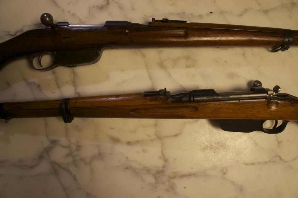

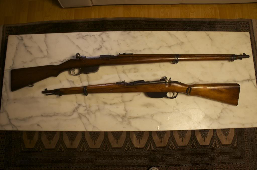

I think there are some other points I should also add to all of our other gibberish.
For now, since there are a lot of variations one will encounter, like Czech made BRNO M.95's, Polish reworks..etc. I'll touch only on what are the most common encounters of the Österreichisch-Ungarische (Austro-Hungarian) M.95.
When you're looking at the M1895 straight-pull Mannlicher, be it an M.95, M.95/30, 31.M or M.95/34, there are some basic points to keep in mind so that you know what it is you're actually looking at.
I know I'm going to repeat myself as I mentioned some stuff before and in addition to some of Marcus' good info...but just to condense it all, we'll start with what the difference is in why it's an M.95, M.95/30, 31.M or M.95/34.
M.95 - These will be original un-converted, un-refurbished pieces that are still chambered in the original WWI 8X50mmR or "M.93 O-Patrone" cartridge. A correctly matched M.95 will only be serialized on the receiver, bbl, LEFT side of the butt-stock and often on the top hand-guard under the rear ladder leaf sight with the last two digits of the serial. Bolts were not serialized. Original M.95 8x50mmR rear ladder sights were graduated to 500-2400 schritt (or "steps").
M.95/30 - Austrian converted beginning in 1930 to the 8x56mmR, or "M.30 S-Patrone" cartridge. This Austrian conversion is noted by a large "S" stamped on the top of the chamber ring on the barrel, which stands for "Spitzgeschoss" or quite literally "Pointed Bullet". M.95/30's also received a taller front sight and a new rear ladder sight graduated to 300-2000 meters to compensate for the new and more powerful M.30 (8x56mmR) cartridge.
31.M Puska - This was the Hungarian's re-designation of their newly converted M.95 to 8x56mmR. Which the adoption of the new 8x56mmR for the Hungarians began in 1931. Hungarian converted 31.M will be stamped with a large "H" on top of the barrel/chamber ring, much like in the same manner of the Austrian "S" stamp. This "H" stamp stands for "Hegyes Tolteny", also quite literally translates to "Pointed Bullet".
M.95/34 - The M.95/34 are all the M.95/30 and 31.M 8x56mmR conversions..etc that were sent to Bulgaria after WWI from Austria and Hungary in addition to all of the Bulgarian M.95 contract rifles that remained in Bulgaria and went through the 1930's Bulgarian refurbishment and rebuild process. No where else was this designation of "M.95/34" used but from Bulgaria and is found in Bulgarian manuals of the time. Part of this rebuild, the Bulgarian's re-stamped numbers on M.95/30, 31.M parts such as bands, stocks, barrels and or the receivers. Bolts were also commonly electro-penciled to match. So, whenever you encounter stamped bands, stamped or electro-penciled bolts or serial numbers on the RIGHT side of the Butt-stock...etc, these are all signs of the Bulgarian post-war ownership and the M.95/34 rebuild.
Alright, clear so far?
Now, onto the basic configurations of the M.95.
First, is the Repetier-Karabiner: or "Carbine". This configuration will have a set of sling swivels mounted on the side only. One side swivel on the lower band, and one side swivel in the wrist. There is also a 7" distance between upper and lower bbl bands. Original M.95 Repetier-Karabiner upper bands had no bayonet lug or stacking rod. Original lug-less/rod-less Karabiner bands are VERY scarce. Later, Karabiner upper bands received a bayonet lug, literally welding or braising on a lug to the band. These lugged Karabiner bands are also quite uncommon to find, as just prior to WWI, most rifles were fitted and updated with Stuzten upper bands that had stacking rods and bayonet lugs.
Next we have is the Repetier-Stutzen:
This configuration will have a set of sling swivels mounted on the bottom side only. One bottom swivel on the lower band, and one bottom swivel on the butt-stock. There is a 5" distance between upper and lower bbl bands. Original M.95 Repetier-Stutzen upper bands all had stacking rods and bayonet lugs.
Next, is the Repetier-KarabinerStutzen:
This configuration will have 3 sets of sling swivels as well as side sling-bar. One bottom swivel on the lower band as well as a fixed side sling-bar. One side swivel in the wrist and a bottom swivel on the butt-stock. There is a also a 5" distance between upper and lower bbl bands. Repetier-KarabinerStutzen also have the Stutzen upper band with stacking rods and bayonet lugs.
Now, the Repetier-StutzenKarabiner:
This configuration is just like a Repetier-Karabiner Stutzen, having with 5" between bands. But rather than a fixed side-bar lower band, it will carry side & bottom swivels on lower band band, a side swivel in the wrist and a bottom swivel on butt-stock. This will also carry a Stutzen lugged and stacking rod upper band.
And finally, the Repetierkarabiner mit Stutzenring:
This configuration is simply a Repetier-Karabiner having 7" between bands with a side swivel on the lower band, side swivel in the wrist and fitted with a Stutzen lugged/stacking rod upper band.
Clear as mud? I know it's a lot to take in but I promise I'm almost done.
Long rifles and cut downs:
It's quite obvious when you encounter a long rifle, so I'll touch briefly on how to spot a cut-down long rifle. Note, that just about ALL Repetier-Stutzen, Repetier-KarabinerStutzen, Repetier-Karabiner, Repetier-Karabiner mit Stutzenring, and Repetier-StutzenKarabiner had short ladder rear leaf sights and wedged mounted front sights. The tell-tail signs of a cut-down long rifle will be a short rifle bearing long ladder leaf sights and a banded front sight. Also note that sometime during a rebuild, a short Karabiner/Stutzen type was re-barreled with a long rifle barrel bearing a banded front sight. A quick check of the serial number on the receiver and barrel will determine this if they match, not just along with the same number, but also same style of font. As noted before, the Bulgarians would commonly scrub the non-matching number and force-match barrels on their M.95/34 rebuilds and it's obvious when the number fonts don't match the original receiver numbers.
Now, one might ask "My short rifle has a long rifle banded front sight, but the rear ladder sight is short...what gives?"
There are two possible scenarios to this -
1.) It has been made from a cut-down long rifle, and during its modification to a short rifle, it was fitted with a short ladder rear sight.
2.) During WWI, to speed up barrel production for carbines, banded long rifle front sights (as opposed to the dovetailed/wedge mounted carbine sights) were also known to have been used on some new carbine barrels.
So it doesn't necessarily always mean that a particular short rifle with a banded front rifle sight, bearing also a short ladder rear sight was made from a long rifle.
Nevertheless, IMO, that doesn't affect the beauty of these rifles.
Receiver markings and part letters.
STEYR marked receivers are pieces made in Austria.
Parts you find that are stamped with the letter "K" are all Austrian made.
Austrian acceptance stamps on top of the bbl/chamber-ring will bear the stamp of W-n (Austrian eagle) and the last two digits of the year of that specific rifle's acceptance.
The "W-n" stamp stands for Wiener-Neustadt located south of Vienna in the state of Lower in North-East Austria.
BUDAPEST marked receivers are pieces made in Budapest, Hungary.
Parts you find that are stamped with the letter "R" are all Hungarian made.
Budapest acceptance stamps on top of the bbl/chamber-ring will bear the stamp of BP, a single shield or double shield (the double shield starting with the change of Monarchy in 1916 after the death of Emperor Franz Josef) and the last two digits of the year of that too, specific rifle's acceptance.
There are many M.95 that were built in Budapest but were accepted in to service in Austria.
So it's not uncommon to find a Budapest made rifle bearing the Austrian Wiener-Neustadt "W-n (eagle)" acceptance stamp.
There are also early, late and Ersatz (substitute standard) style of parts such as sling swivels, cocking pieces, inner structures of butt-plates, top guards...etc. Though, we'll save that for another day if the need arises.
But ALL parts from both Austria and Hungary M.95, whether early or late style are interchangeable. And it's also common to find "K" and "R" marked parts mixed with each other.
Bulgarian crested receivers are A-H made pieces under contract for Bulgaria and the design was exactly the same.
Correct Bulgarian contract rifle bolts however, will have a gas relief hole in the top forward portion of the bolt-body.
Hope your eyes aren't crossed now and that helps expand on what to look for when you've entered the world of the M1895 straight-pull Mannlicher and it's variants.

Here are my his and her matching Steyr 1895 Long Rifle and Carbine.
Going by what i read above by GOEX, i have learned the following about these rifles.
1. The Long rifle is all habsburg; stamped with lots of little K peenings and is all matching. There is no import mark. The bolt stock and front band all appear to match.
2. The shorty is a good example of, what i would suppose after reading the above, a good example of a bulgarian refurb Repetier-Karabiner; swivels on the left side, electric pencil matching, stamp on right side of stock
I am grateful for the Meisters wisdom above, especially Goex and Markus von Doggenlieber
