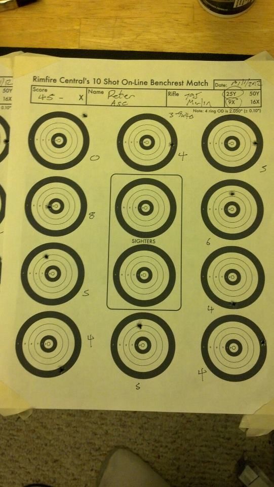

turns out I was able to get out to the range today, here's my best at 50 yards benched with a bipod and prostaff scope and CCI mini mag
from the very bottom edge to the very top edge thats a hair under 1 inch

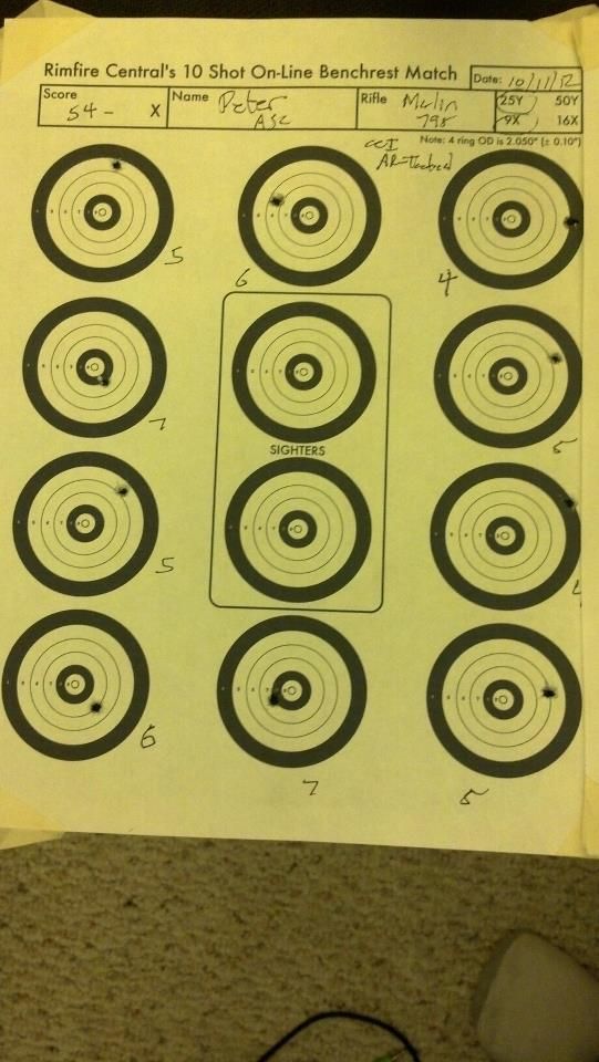

Yesterday took my brand new 795 with tech sights to my indoor range, and happy to say that its crazy accurate and real fun with tech sights (stock ones are real crap). I had one FTF issue in around 100 rounds it may be ammo, was using Walmart Federal.
Glad i picked 795 instead of 10/22:-)

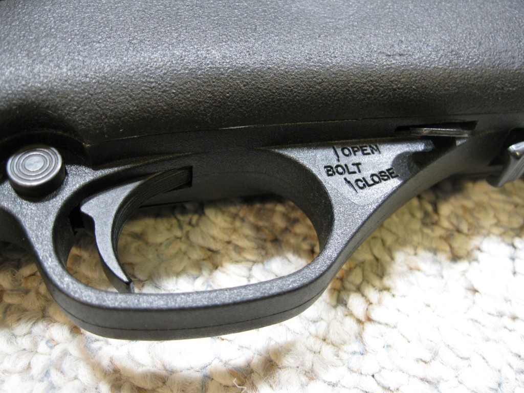

My 795 seems to be acting up. I first noticed it at Appleseed where it seemed to be misfiring occasionally. One of the instructors tried it and couldn't reproduce the issue and we thought it might be because the rifle was dirty. Also, there was no audible or felt reset of the trigger after releasing from firing, but I had it set up that way with the DIP trigger guard and made a mental note to adjust the screw when I got home.
I brought it home after Appleseed to clean the rifle and put a Boyd's stock on it. I also adjusted the over travel screw but noticed that at a certain point the trigger stopped before hitting the screw. If I removed the trigger guard from the rifle, the trigger traveled back fully.
Today when I went to shoot it, I was having problems where it wouldn't fire after I loaded it and hit the slide release. I found that if I wiggled the magazine back and forth, I could get it to fire. But by the end of the session even wiggling the magazine back and forth did not work. I had to manually remove the magazine and re-seat it before the weapon would fire. I did this for each round.
Any ideas on what might be happening? Should I just send in my rifle to Marlin and ask them to look at it? (I'd have to test it with the factory trigger and stock since I'd be sending it back with both.)

So do you have just the DIP trigger guard or do you have a DIP trigger too?
It sounds as if you have the pretavel screw on the trigger set too high and needs to be backed off.
The wiggling of the magazine is moving the action back and forth and allowing the trigger and transferbar to work together.
Also are your stock screws tight? If they are too loose they will allow the action to move forward under the pressure of the trigger.
IMO but I doubt Marlin will do anything with it because its aftermarket parts.
Try it with the stock trigger and see what happens
Then try it with the DIP trigger screw backed off
Make sure your action screws are tight for both of these tests.

  #275
Old 11-23-2012, 3:45 PM
ogarcia_02 ogarcia_02 is offline
Join Date: Nov 2011
Posts: 1,406
iTrader: 11 / 100%
Default
Got my 795 today at Dicks for 166 OTD, waiting to get it out so I can try it out.
Reply With Quote
  #276
Old 11-23-2012, 4:16 PM
Chaos47 Chaos47 is offline
Join Date: Apr 2010
Posts: 6,660
iTrader: 19 / 100%
Default
Quote:
Originally Posted by psygho View Post
Excuse me for mine bad english.. (native language is dutch)
I,m plannign to buy an marlin 795. But i have an few questions.
There where 2 in the shop. (both where new) One had the "normal" bolt handle, and sights.
I did not get the serial unfortunatly....
But one other one had the adjustible marlin sights.
Buthas not the "normal" bolt handle, but like this one:
The serial: 00186XXX
Is this an older model of the 795, or an new one ? or is is just manufacturer modified/updated) ? If i buy something i like the best model. Wich would be a smarter choice ??
Thnx in advance..
Hi psygho,
Welcome to CALGUNS!
Your English is fine! So do not worry!
Unfortunately I do not know too much about the configurations that they sell outside the USA. I know that they do make some versions of models that are not sold in the USA and only out of country.
Did you actually see that they where both marked 795 on the barrel?
My guess would be that the one with the older style bolt handle and adjustable sights is actually a Marlin 70. Which is an older model of the 795.
In the USA (at least older Marlins) age can be figured out by subtracting the first two numbers from 100.
So in this case 00186XXX ignoring the 00 would seem to be made in 1982.
But again there is no telling if this formula carry's over to rifles outside USA.
New MM prefix Remington made Marlins do not fit the 100 - first 2 digits formula. And there is as of now no known formula for them.
So:
It could be a Marlin 70. (Or other older model)
It could just be a different variation made for outside the USA.
It could be a variation made for a certain Distributor.
It could have been modified by it's previous owner. (But you say its new..)
Did you happen to see if the one with the different handle and sights has the Last Shot Hold Open Lever? "LSHO"
It looks like this:
It extends out and below the trigger guard. Seen here near where the guard reads Open Bolt Close:
Older 70 do not have these. They are a very handy feature that locks the bolt back when the magazine is empty. You then just insert a full magazine press down on it and it releases the bolt loading a round.
I believe that there where a few late production years that the 70 did have the LSHO.
In closing, I would inspect them both if they both are new and they both have the last shot hold open and they are both the same price. I would go with the one with the different handle and sights. It is said that the older production rifles where made with more care. (I have 2 MM serial numbers and think they are perfect though..)
If the different one does not have the last shot hold open lever then I would go with the one that does. In my opinion this is a great feature. You can always upgrade your sights and change the bolt handle. You could not add the LSHO without a lot of work probably.
Hope this helps.
Let us know if you go back and look at them again to see if one is really a 70 and which one you decide on.
Let me know if there is anything else I can help with!
