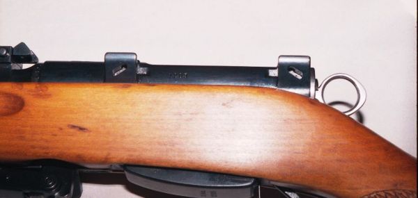

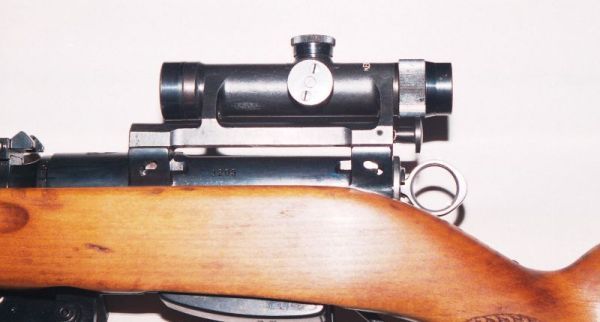

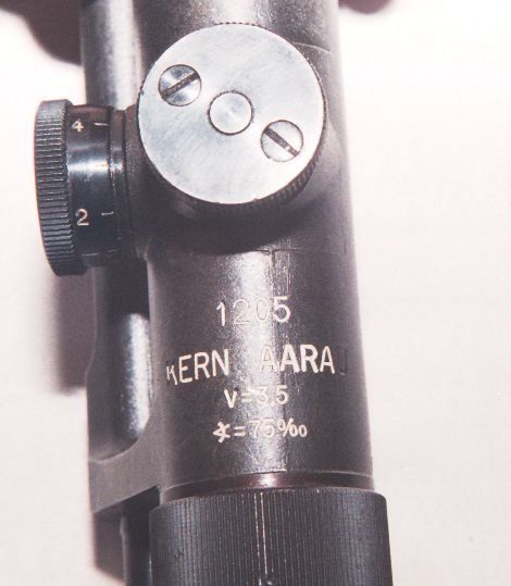

The k31 and it's mates, the 96/11, 1911, k11 and the rare (in the US) zfk55 Swiss Sniper Rifle are a rarity in another category. A Military series of rifles rifles designed around a specific cartridge for accuracy and performance. All use the same original GP11 cartridge.
The intent of this cartridge/rifle mating was to hit a human in the kill zone at range and they performed as intended. Not many production rifles are capable of doing that at real range. The very great majority of these rifles perform exactly as intended.
Are there rifles that outperform it? Of course there are, but none of them are a standard military issue firearm designed around a dedicated production cartridge for that rifle.
The purpose of this missive is to illustrate that there are differences between issue rifles and custom made and custom tuned rifles.
P.W. St.Marie

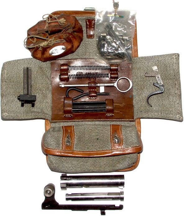

So your rifle came to you in the usual condition of the k31. Stock a bit beat up but with most of the metal finish intact and sharp, shiney lands and grooves, and you intend to keep it that way.
Stop and think about this. The rifle came to you in the condition in which the Swiss soldier and Armoury kept it for many years. Is it not then a reasonable assumption that you'd follow the same maintenance ritual that has kept it in that condition for so many years? Maybe, but the average American shooter believes strongly in all of the advertising hype and testimonials to a myriad of maintenance products deemed absolutely necessary to keep a rifle as pristine as possible, few of which are factually relevant to the k31 barrel.
This was written by my Dad quite a few years ago.
The Armoury and the well instructed Swiss soldier used a product called Waffenfett, or weapon grease. A close and reasonable approximation in the US is Lubriplate 930. The barrel is swabbed with 930, running a patch back and forth followed by a dry patch. At the end of the shooting session while the barrel is still hot or warm, the lubriplate is worked back into the barrel and left that way until the next shooting session when a dry patch is run back through removing the excess lubriplate. That's it. If carbon in the throat and chamber become an issue from firing reloads, use a good carbon remover such as Montana Extreme, but leave the bore alone. It is a fact that excessive bore cleaning with brushes can and will shorten your barrel life.
If, by shooting reloaded cartridges utilizing copper jacketed projectiles, your bore shows copper fouling, use a product such as WipeOut to remove it. This kind of a product fulfills it's task without continual scrubbing of the bore.
This may sound like an overly simple approach, and the typical US shooter is usually a ready recipient of industry marketing efforts and barrel maintenance, but use this logic. My 50+ year old rifle came to me with a truly amazing bore. Why would I not then follow the maintenance practices of the Armoury and Soldier that delivered it to me in this condition?

And contrary to some of the misinformed info about the Scope Mount being a problem to load with a charger.
http://www.youtube.com/watch?v=5pQCK...eature=related

The Crown Jewel
Thanks to Big Lee Ertsman
The zfk55.
Model 1931/55 Sniper Rifle (AKA Zf. k31)
Barrel Length - 25.65 inches: 4-groove, RH, concentric rifling, 1 in 10.63
Overall Length - 47.55 inches
Weight - 13.5lbs empty (with scope attached)
Action - Simplified Schmidt-Rubin Straight Pull
Caliber - 7.5x55 Swiss (GP11)
Capacity - 6 round detachable box magazine
Sights - Tangent-leaf sight graduated to 1500m
Total Production - 4150
Bayonet: Models 1918, 1918/55 and 1914 Pioneer (Sawback)
Note that the Bipod is attatched directly to the receiver and held in place with locking screws.
This feature keeps all of the support of the rifle away from the barrel and
forestock, leaving it relatively free floating.

Note the offset magazine. This allowed the receiver to be canted at a 15 degree angle thereby
facilitating ejection of spent brass off to the right, clearing the over-the-bore scope mount.

Every part of the zfk55, including the scope and it's cannister are stamped
with the rifle's serial number.

Swiss Products zfk55 Scope Mount replacement. The issue Kern scope is an integral part of the mount that
slides into the receiver. We developed a scope mount replacement that allows the use of any scope in the
world.
And an explanatory link.

Default the zfk55 Maintenance Manual in English
http://www.swissrifles.com/sr/manual...Manual_Eng.pdf

Default
Why such a narrow scope rail for the K31?
If you try converting to a Weaver mount, the k31 ejecting straigt up will allow the case to hit the Weaver rail and/or Scope and drop right back into the receiver. Further, it will skin your knuckles on the right side when cycling the bolt.
The SP rail is Mfg'd the way it is for a reason. Clearance, and I know all about the mount that is a Drill/Tap on to of the receiver. We've made them here too as prototypes, but our philosophy is that if we design something that will not function 100% of the time, we're not going to produce it.
These photos were put together by Guisan showing the function of our mounts.
And, no............ your POI change will not be discernable between 100 and 300 yards if you zero the rifle at 100 yards. The offset is not enough for a good shooter to see any marked difference. At 400 and 500 yards you will still be in a heart kill-zone on game. .................. etc.

Default Diopters
This is the production model.
The Diopter clamps to the right side of the ejection port requiring no alteration to the rifle. It comes complete with front sight.
It shoots from 75 yards to 1,000+ yards. It's eye relief adjustable at two points on the rail.
It has a Patent Applied For internal double buffer spring system to give it smooth travel the full elevation travel.
This is the Distinguished Naval Marksman who proofed and published the report on the the prototype at Quantico.
This is production model #1 Type P/S Diopter in it's presentation case dedicated to him.

Default Taking care of your Swiss Rifle.
http://www.swissrifles.com/sr/englis...k31_manual.pdf
Good idea to download this one.
