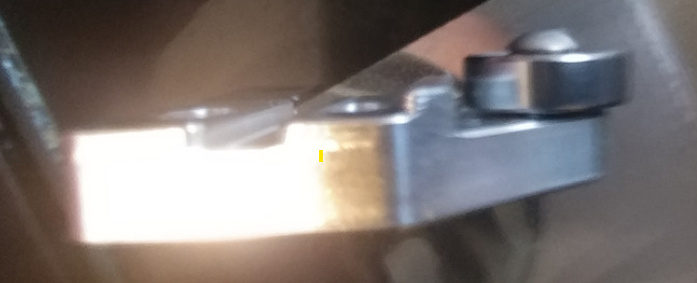

I AM sure now... during reassembly... it appears THIS bad boy was my problem...
This wasn't clearing the index ring on the primer seating stroke, which I was aware of it touching, but it CLEARLY (upon disassembled inspection) was putting force on the index ring...
I put the OG Dillon index block back on, and it clears and should not break again, I assume.
Anyone know if the Amazon listing for the "Armanov Index Bearing Cam Block for Dillon Precision XL-650 XL650", or the
"Dillon XL650 Index Bearing Block" from badman bullets clear the Index Ring on the primer seat forward stroke?
